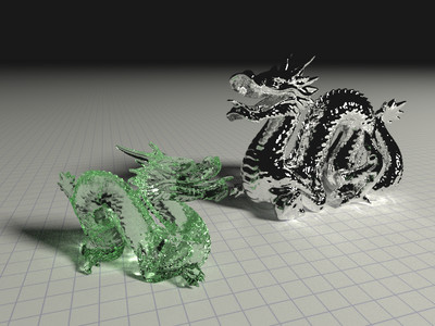

I have implemented simple kd-tree support for my renderer ssRay and it
already rocks! See the image attached. Now I can finally use more
interesting models and render complex scenes without unbearable
performance hit.
Now the kd-tree is build with idiotic spatial median subdivision (ie.
simply divide each node in half). That is stupid and I'll implement a
surface area heuristic cost model next. That should improve performance
considerably. But still, all looks pretty good so far!
I love this path tracing stuff :D

It's snakes on a *** plane!  I like it.  Really, it's no small feat to get this
far.  What's after kd-trees?

Wow that's really cool that you have done this all yourself so quickly, at
this rate you'll be ahead of POV in a few months :-)
