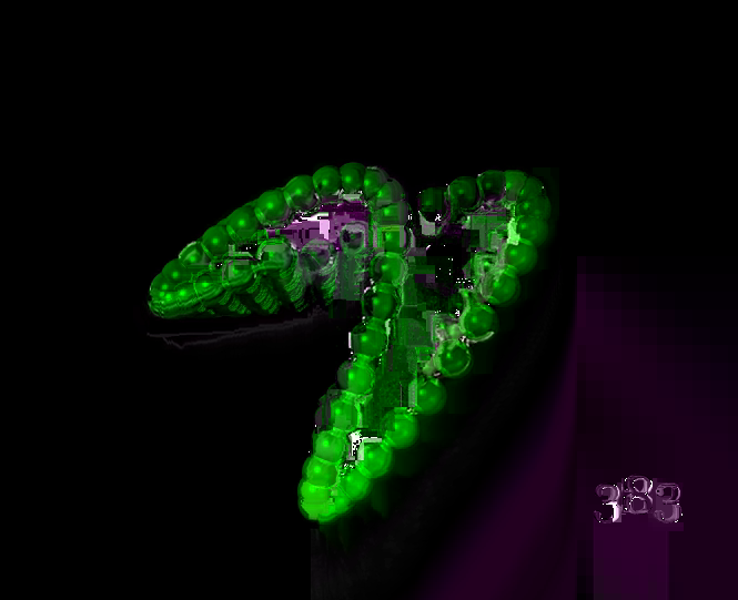

Orchid XP v8 wrote:
> H.264 lossless was smaller still, but on playback the
> picture was spectacularly broken. Even in Virtual Dub, all the colours
> are mixed up and there are random lines everywhere and it basically
> looks like a bug in the codec. It is *not* lossless!
In case anybody wanted to know what I mean by "spectacularly broken"...
http://blog.orphi.me.uk/
http://www.zazzle.com/MathematicalOrchid*
Download 'broken1.png' (128 KB)
Preview of image 'broken1.png'
