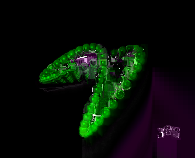

OK, so my PC has spent the entire evening encoding and re-encoding the
same AVI over and over again. And the results are in:
12-Flower3-v1-Part.avi
6,351 frames, 720x576 pixels, 24 bits/pixel, 25 frames/second.
Uncompressed:         7,901.797 MB,               14% CPU on playback.
FFDshow Huffyuv:        746.872 MB, 1:45 encode,  20% CPU on playback.
FFDshow FFV1:           547.746 MB, 5:09 encode, >50% CPU on playback
(failed to play in realtime).
FFDshow MPEG1:           28.947 MB, 1:35 encode, Completely broken on
playback.
FFDshow MPEG2:           28.947 MB, 1:35 encode, Playback refused.
FFDshow XviD:            28.782 MB, 1:39 encode,  13% CPU on playback.
FFDshow DivX:            28.952 MB, 1:45 encode,  13% CPU on playback.
FFDshow Theora:          28.298 MB, 2:19 encode,  16% CPU on playback.
FFDshow H.264:           29.061 MB, 3:50 encode,  21% CPU on playback.
FFDshow H.264 Lossless: 252.069 MB, 4:22 encode, Completely broken on
playback.
TPMGEnc MPEG1 30Mbit:   148.213 MB, 1:47 encode,  17% CPU on playback.
TPMGEnc MPEG1 900Kbit:   27.168 MB, 1:43 encode,  17% CPU on playback.
As you can see, this conclusively proves... something.
Actually, you know what? My head hurts!
All of the ones that say "FFDshow" where encoded using Virtual Dub and
the selected codec with all defaults. (Apparently that means 900
Kbit/sec in one-pass average bitrate mode. I didn't even *look* at the
defaults for the advanced settings...)
As far as lossless codecs go, only Huffyuv is actually usable. FFV1
produces somewhat smaller files, but it's too slow for realtime
playback. (As you can see, it locked up one core of my dual-core
processor.) H.264 lossless was smaller still, but on playback the
picture was spectacularly broken. Even in Virtual Dub, all the colours
are mixed up and there are random lines everywhere and it basically
looks like a bug in the codec. It is *not* lossless!

From: Orchid XP v8
Subject: Spectacularly broken
Date: 3 Nov 2008 16:48:06
Message: <490f7196@news.povray.org>
In case anybody wanted to know what I mean by "spectacularly broken"...
http://blog.orphi.me.uk/
http://www.zazzle.com/MathematicalOrchid*
Download 'broken1.png' (128 KB)
Preview of image 'broken1.png'

From: Orchid XP v8
Subject: War of the codecs II
Date: 5 Nov 2008 06:34:16
Message: <491184b8$1@news.povray.org>
Orchid XP v8 wrote:
> I should probably just start over with a better test video!
OK, so I started again, this time with a custom-rendered Electric Sheep
video. In other words, it features intricate fractal detail, vibrant
colours, full-frame complex swirling motion, and high-quality motion blur.
S026m-Anim2.avi
720x576 pixels, 24 bits/pixel, 25 frames/second, 420 frames.
Uncompressed:         498 MB
Huffyuv: 0:08 encode, 105 MB
FFV1:    0:37 encode, 176 MB
MPEG1:   0:16 encode, 3.40 MB
Theora:  0:28 encode, 4.16 MB
DivX 3:  0:08 encode, 1.96 MB
XviD:    0:12 encode, 2.11 MB
H.264:   0:38 encode, 4.73 MB
Well that definitely says... something. (In particular, FFV1 now does
drastically worse than Huffyuv, despite being much slower to encode and
too slow for realtime codecing.) But how good does the lossy video look?
All of the video was encoding at "900 Kbit/sec average bitrate". And
yet, they differ fairly widely in file size. Perhaps unsurprisingly
then, we find the following:
- MPEG1 looks *horrible*! I mean, *really* horrible. (Recall that with
my previous test, 900 Kbit MPEG1 actually looked not much different from
the uncompressed original. Clearly I picked a test case that was far too
easy!)
- DivX 3 looks even worse than MPEG1. And not by a small margin.
- XviD looks better than MPEG1.
- Theora looks quite a bit better than XviD.
- H.264 looks really very good indeed. Considering the file is over 100x
smaller than the original, there is surprisingly little distortion.
So we have roughly
   DivX < MPEG1 < XviD < Theora < H.264
This follows the file sizes almost exactly, except for MPEG1.
I had assumed that given the same average bitrate, all the codecs would
produce a file roughly the same size. This isn't really the case here. I
guess now I'll have to spend a few hours trying to get each codec to
produce a file of roughly the same size so I can compare those...
