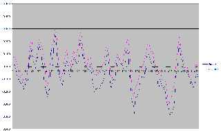

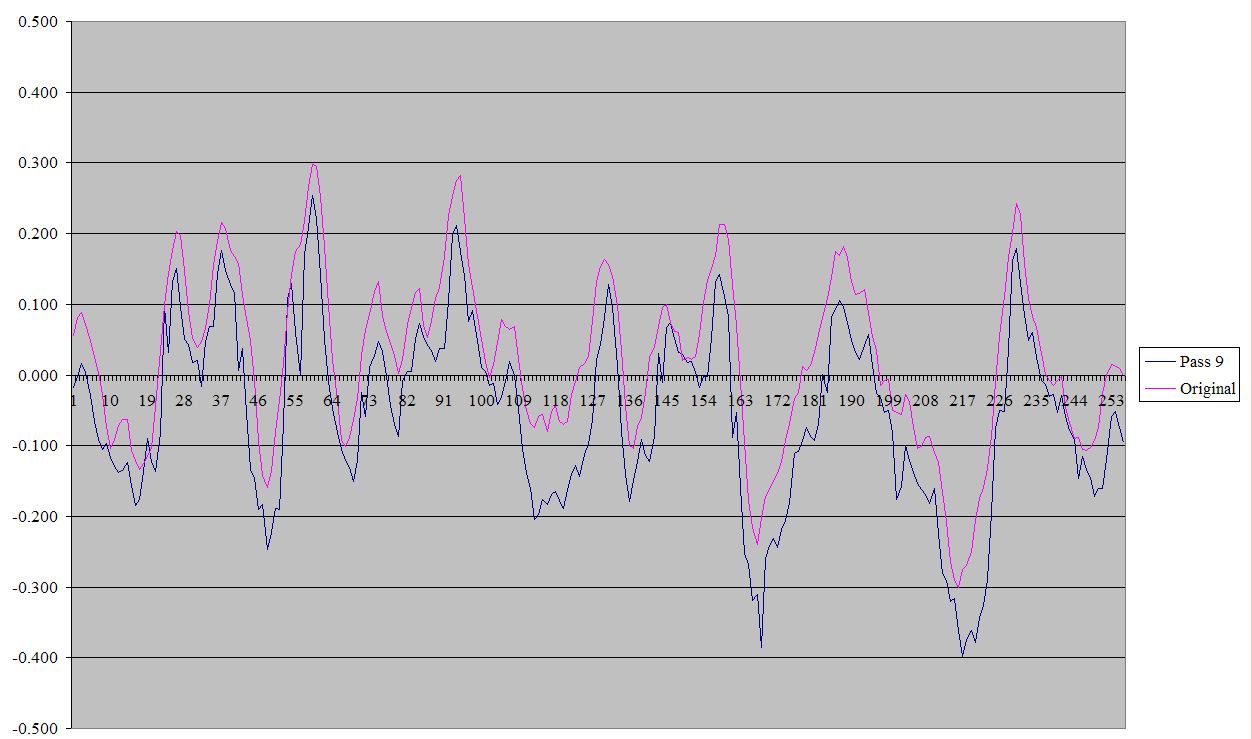

And now for something... completely pointless.
Take a look at the attachment. The trace marked "original" is just some
random data I made up. [It's the output of a random number generator fed
through a band-pass FIR filter with a wide pass-band.] This trace
basically consists of 256 double-precision numbers.
I then took this data, compressed it using the Fractal Transform
(yielding 32 positive integers and 64 double-precision floats), and then
decompressed it again.
As you can see, the two signals correlate reasonably closely. As you can
*also* see, they're not exactly identical by any stretch. Hmm... I think
my program is buggy. :-S

it looks to me as if the volume got turned down slightly.

As this Fractal Transform is not lossless, what exactly is your problem?
Other than that it is apparently the wrong compression technique for
this kind of signal of course.
>> can *also* see, they're not exactly identical by any stretch. Hmm... I
>> think my program is buggy. :-S
I was hoping for a closer fit than that.
Mind you, I started out applying this to image data. Only problem is
that the decompressed image bears *no resemblance* to the original. I
don't know what I've done wrong, but it's clearly horrifically broken.
So I thought I'd try the simpler 1-dimenional 1-channel case. And as you
can see, it more or less works...
Or rather, I couldn't find a good signal to test it with. ;-)

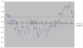

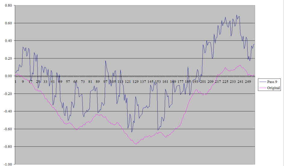

Well, I've run a few signals through my program, and they all seemed to
work kinda OK. But just now I threw together a simple fractal noise
generator. (Midpoint displacement method.) And then I ran that through
the program, and WOAH! Something has gone terribly wrong here...
