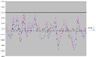

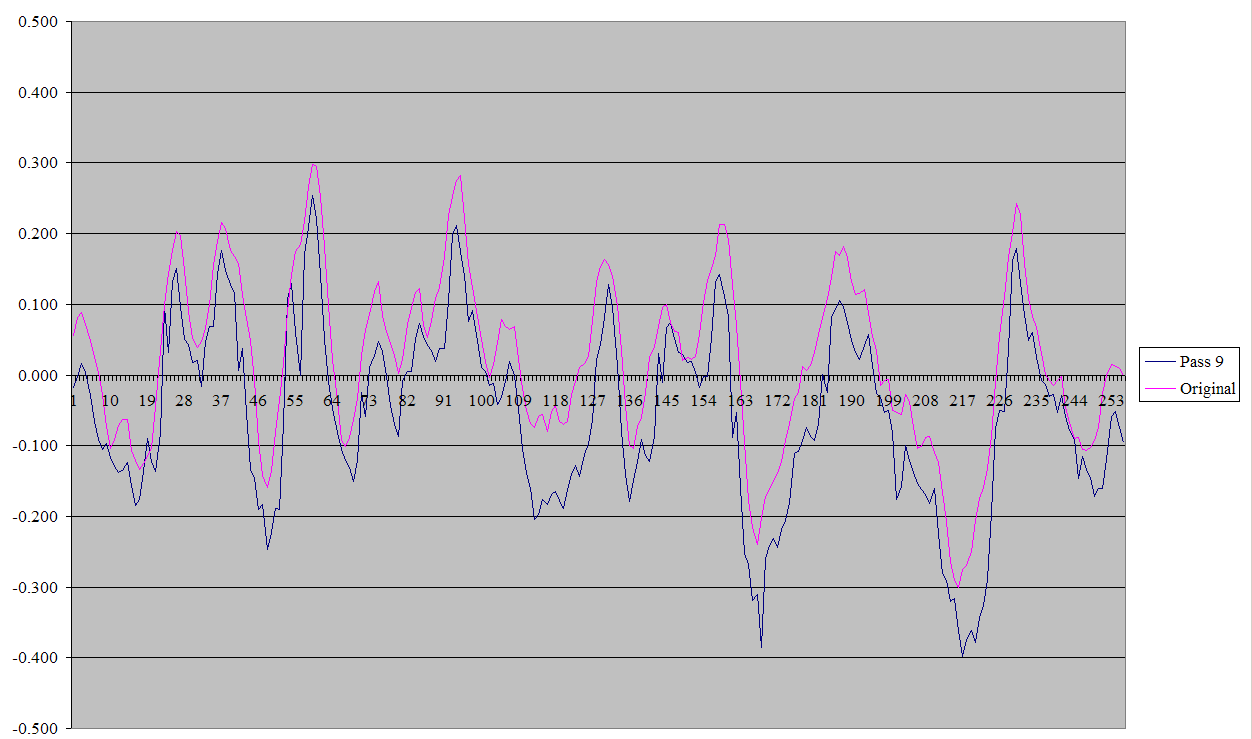

And now for something... completely pointless.
Take a look at the attachment. The trace marked "original" is just some
random data I made up. [It's the output of a random number generator fed
through a band-pass FIR filter with a wide pass-band.] This trace
basically consists of 256 double-precision numbers.
I then took this data, compressed it using the Fractal Transform
(yielding 32 positive integers and 64 double-precision floats), and then
decompressed it again.
As you can see, the two signals correlate reasonably closely. As you can
*also* see, they're not exactly identical by any stretch. Hmm... I think
my program is buggy. :-S

From: Tom Austin
Subject: Re: Completely pointless
Date: 28 Feb 2008 14:03:39
Message: <47c7058b@news.povray.org>
it looks to me as if the volume got turned down slightly.
Tom
From: andrel
Date: 28 Feb 2008 15:18:42
Message: <47C71739.4020601@hotmail.com>
As this Fractal Transform is not lossless, what exactly is your problem?
Other than that it is apparently the wrong compression technique for
this kind of signal of course.
From: Invisible
Date: 29 Feb 2008 04:17:53
Message: <47c7cdc1@news.povray.org>
>> can *also* see, they're not exactly identical by any stretch. Hmm... I
>> think my program is buggy. :-S
I was hoping for a closer fit than that.
Mind you, I started out applying this to image data. Only problem is
that the decompressed image bears *no resemblance* to the original. I
don't know what I've done wrong, but it's clearly horrifically broken.
So I thought I'd try the simpler 1-dimenional 1-channel case. And as you
can see, it more or less works...
Or rather, I couldn't find a good signal to test it with. ;-)

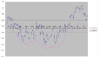

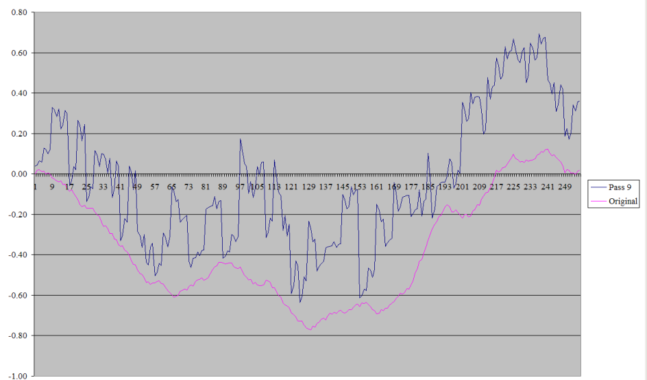

From: Invisible
Date: 29 Feb 2008 05:33:43
Message: <47c7df87@news.povray.org>
Well, I've run a few signals through my program, and they all seemed to
work kinda OK. But just now I threw together a simple fractal noise
generator. (Midpoint displacement method.) And then I ran that through
the program, and WOAH! Something has gone terribly wrong here...
http://blog.orphi.me.uk/
http://www.zazzle.com/MathematicalOrchid*
Download 'compress2.png' (56 KB)
