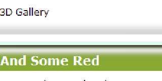

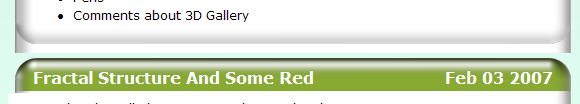

I tested your site with IE7, and I see a couple of rendering errors. The
first occurs at every 'box'. It manifests as a continuance of the
left/right box graphics extending below the bottom graphic (shown in
attached image). I also get the unshaded left border at each box. All
these boxes are affected by the unshaded left border: 'Fractal Structure
And Some Red', 'Burn in Hell', 'No More Chrome Spheres Please', 'Merry
Christmas on The South Pole', 'Tunnel', 'Impossible Triangle', 'Red
Dragon', 'Tubes', 'Torus Fractal', 'Green Dragon' and 'Pens'.
I hope this helps.
> attached image).
Eep, that's even worse than in IE6! How could that happen...?
Yeah, it's all the ones where the image to the right extends lower down than
the text, for some reason.
> I hope this helps.
It helps me take it extra seriously, when I know that IE7 hasn't fixed these
issues as I had hoped. :(
