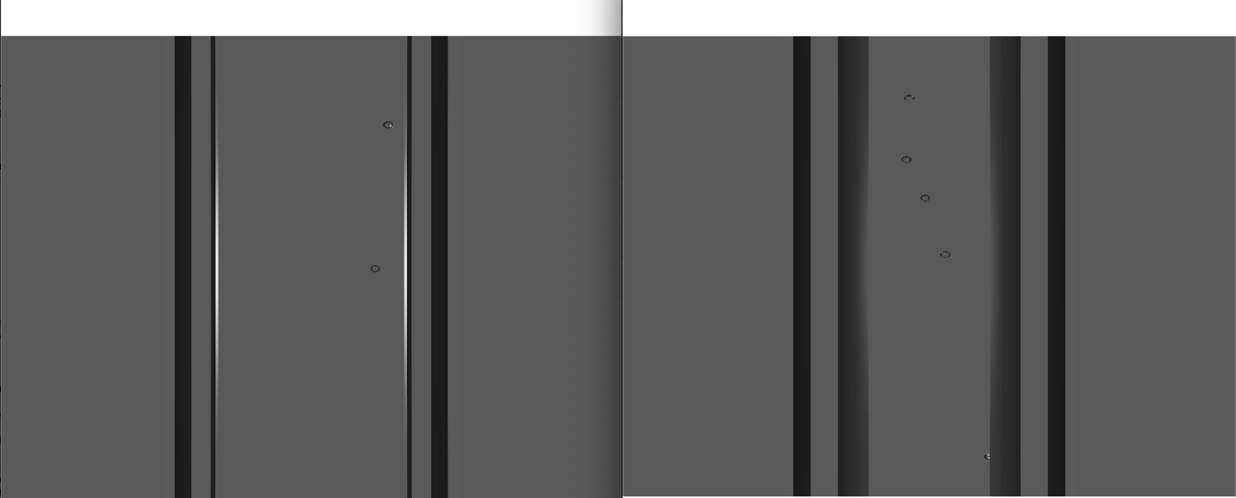

2). Rendering Issue and the appearance of dark regions after animation
rendering:
My next question pertains to a rendering issue I have run into.  I reformatted
my previous script with the generous input of forum users.  Here I have defined
each region of my setup in a more efficient manner that I was perviously.  In my
attached file, I am simulating air bubbles trapped in a gel housed within a
glass tube.  Outside of this tube is a cylinder of water and then a cylinder of
plexiglass.
When I first rendered my setup, everything was looking good, and so I decided to
run it as an animation, rotating the bubbles around Y axis.  However, when I ran
the animation, the boundary between the glass and water appeared to be speckled,
which immediately made me think of an overlapping surface issue.  I addressed it
by adding an "epsilon" to the radius of my water cylinder's inner surface and
ran it again.  While the speckled surface issue was resolved, a large portion of
my cylinder is being rendered as a dark region, and this region will not go away
no matter what I do, and I cannot recreate the original bright region.  I also
tried turning off the fade and this did not help.
Can anyone help me troubleshoot this issue?
Thank you all for your support and insights!

PlexCyl
Download 'screenshot 2021-12-03 at 13.33.01.png' (338 KB)
Preview of image 'screenshot 2021-12-03 at 13.33.01.png'
From: bubble person
Subject: Re: Area_light and Rendering Dark Regions after Animation
Date: 3 Dec 2021 07:55:00
Message: <web.61aa13671a80054d16bfacdf7c94cc22@news.povray.org>
"bubble_person" <nomail@nomail> wrote:
> Hello Forum,
> I recently posted about about trying to simulate bubbles in a tube and received
> a lot of great feedback on my scripting approach!  I've made changes to my
> previous setup to clean it up, but have two outstanding questions/issues.  The
> first is on the area_light function, and the second is an issue that I am having
> when rendering my new script.
Hello Forum,
I missed the reply from Alain in my previous post which gave a stellar
description of the area_light definition, and he has made it super clear to me.
Thanks Alain!
I am of course interested in how people would approach making a diffuse
backlight, and if my approach of using the looks_like{} function seems
appropriate.  Thanks again, everyone, for your support and help!
Sincerely,
Bubble_person
From: bubble person
Date: 3 Dec 2021 08:05:00
Message: <web.61aa15a21a80054d16bfacdf7c94cc22@news.povray.org>
> Hello Forum,
Hello Forum,
It must be a Friday because the script I included has the definition:
tube_router-epsilon
instead of
tube_router+epsilon
I changed my script out of frustration to try to recreate my previous effects.
The issue I am experiencing happens when I have correctly defined the water's
inner surface as:
tube_router+epsilon
Sorry for the confusion on my part.
Sincerely,
Bubble_person
