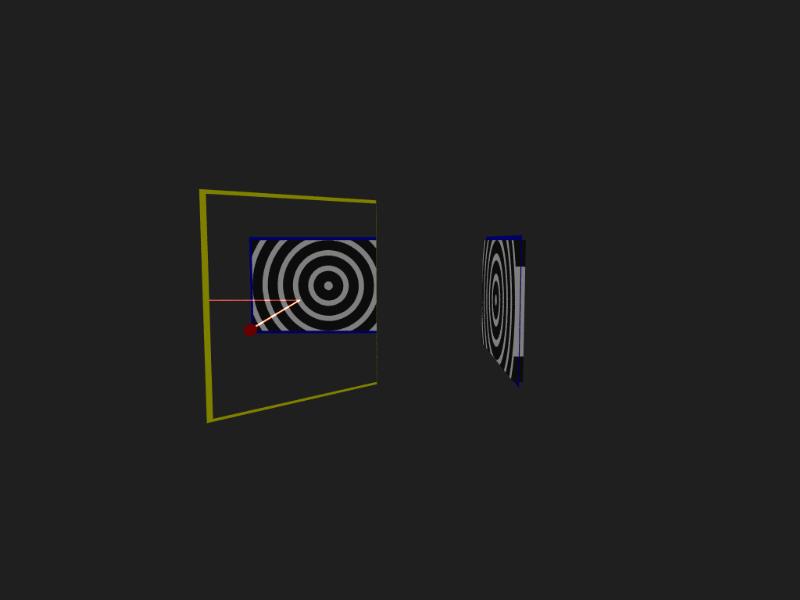

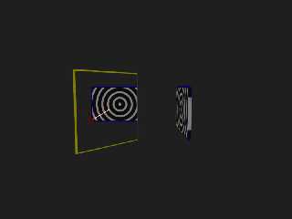

I've been following this post and constructed my own test scene ..... now I
have a few questions.
In the initial scene, after the light leaves the looks_like object it goes
through an optical device then hits an object. I instead wanted to see if I
could get the light beam to bend or deflect with a mirror object. I moved
the beam destination target object 90 from where it was orginally and placed
a mirror object, built centered around <0,0,0> then rotate y*45 and
translated to intercept the light beam and deflect in on to the relocated
destination object. No Joy! I don't even see the point of light on the dest
object. Can POV do this? Or have I messed up the geometry of my test scene.
I've made mirrors before so I just used tried and true settings for the
mirror texture. I can even see the checked floor in the mirror object. I'm
out of ideas so any additional insight would be great.
Jim
From: Reactor
Subject: Re: Laser Light Source with Photons...
Date: 17 Jul 2008 15:40:00
Message: <web.487f9f80f15fb2b6210497120@news.povray.org>
> Jim
Povray can do this, but I would like to see your code so we can figure out why
it isn't.
-Reactor
From: Jim Holsenback
Date: 18 Jul 2008 10:28:04
Message: <4880a874@news.povray.org>
"Reactor" <rea### [at] hotmailcom> wrote in message
news:web.487f9f80f15fb2b6210497120@news.povray.org...
> why
> it isn't.
> -Reactor
Ok ..... here's the source file photons commented out. Don't need that just
yet right?
I've attached a reference image. Notice I can see the target in the
reflective object .... also the reflection of the beam from the source.
That's not the beam bending but it's reflection. I also commented out the
optical device as I don't need that yet either. One change I made was the
intensity of the looks_like light source ..... it WAS a color vector * 1000
..... I just bumped up the intensity of the scattering media to make up for
lowering the intensity of the emitter light source. Orginally the light beam
hitting the target produced an almost white-ish look (highly saturated)
..... a laser beam should leave a red (or light source) colored point of
light .... correct?
Thanks
Jim
global_settings {
  max_trace_level 10
  /*photons {
    count 100000
    autostop 0
    media 1000
    max_trace_level 10
background {rgb 0.125}
#declare Camera =  <15,1.5,2.5>;
camera { location Camera look_at <0,0,2.5>}
// makes the lightsource visable
box {<100,100,100>,<-100,0,-100>
  hollow on
  pigment {rgbt 1}
  //photons {pass_through}
  interior {
    media {
      intervals 1
      samples 1 //5,25
      confidence 1 - 1/1000
      variance 1/1000
      ratio 0.9
      scattering {
        1, color rgb 10
        extinction 0.0
      method 3
      aa_threshold 0.1
      aa_level 4
      density {color rgb <1,1,1>}
// reflector yellow border
union {
  box {<-2.5,-0.1,-2.5>, <2.5,0.1,2.5>
    pigment{rgb 1}
    finish{ ambient 0 diffuse 0 reflection 1}
  box {<-2.6,0,-2.6>, <2.6,0,2.6>
    pigment{rgb <1,1,0>}
    finish{ ambient 0.5}
  rotate z*90
  rotate y*315
  //photons {target reflection on refraction on}
// recptor blue border
union {
  box {<-0.1,-1.5,2.5>, <0.1,1.5,-2.5>
    pigment {
      onion scale 0.5
      color_map {
        [0.0 rgb 1]
        [0.35 rgb 1]
        [0.35 rgb 0.1]
        [1.0 rgb 0.1]
    finish{ ambient 0.5 diffuse 0.5 reflection 0 }
  box {<0,-1.6,2.6>, <0,1.6,-2.6> pigment {rgb <0,0,4>}}
  rotate y*90
  translate <0,0,5>
// optic device
/*sphere  {
  0, 0.5
  pigment{ color rgbt <1,1,1,.95> }
  hollow on
  finish{ ambient 0 diffuse 0 reflection .5  }
  interior{  ior 1.5  }
  scale <0.01,1,1>
  translate <2.5,0,0>
// the emitter
light_source {
  <0,0,0>
  color rgb <1.0000, 0.2900,0.2000>
  cylinder
  tightness 0
  radius .025
  falloff .025
  point_at <-1,0,0>
  fade_distance 500
  fade_power 2
  /*photons {
    reflection on
    refraction off
  looks_like {cylinder{0,<0.1,0,0>,0.1 pigment {rgb <4,0,0>}}}
  translate <5,0,0>
Download 'laser.jpg' (15 KB)
Preview of image 'laser.jpg'
From: Blue Herring
Date: 18 Jul 2008 10:53:33
Message: <4880ae6d$1@news.povray.org>
Hello,
   I've only had a moment to skim your code, but you will need photons
to be able to have the light do anything after it reflects.  I was
messing with something very similar a while back and wrote something
about it here that might help.  Basically I needed to end up bumping up
my photons media parameter (though yours is probably plenty high, just
enable it) and really increasing the media samples.
Here's the message:
http://news.povray.org/web.47af1f65c0351d35b05f96f70%40news.povray.org
There's some other good suggestions in the rest of the thread as well.
This is the scene file when I finally got it working:
http://news.povray.org/web.47af219494e592ceb05f96f70%40news.povray.org
and the corresponding image:
http://news.povray.org/web.47af23af94e592ceb05f96f70%40news.povray.org
Hope its helpful.
-The Mildly Infamous Blue Herring
