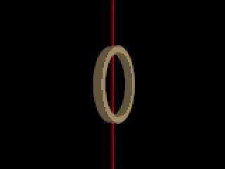

From: frankly
Subject: Still confused...
Date: 25 Dec 2007 18:13:03
Message: <47718e7f@news.povray.org>
Despite your kind efforts Chris and Alain, I am still pretty confused.
These is a cut down versions of the Disc/Ring source files and a small
example of the animated gif it produces.
I have included a red pole to show the axis of rotation.  I want the axis to
be central to the object rather than at one edge.
I have made use of Friedrich A. Lohmueller's geometric objects and shape
include files.
http://www.f-lohmueller.de/pov_tut/pov__eng.htm
the test image
<img src="http://i202.photobucket.com/albums/aa79/simunch/RotaTest.gif">
^^^^^^^RotaTest.pov file^^^^^^^^^^^^^^^^^

I apologise if I have posted too much text or if graphics are a no-no.  I
have no
newsgroup netiquette yet...
Let me know if you can spare the time.
Thanks again - POV-Ray is amazing!
Download 'RotaTest.gif' (24 KB)
Preview of image 'RotaTest.gif'

Hi Simon,
This defines a ring that's 0.35 units thick, initially lying on the XZ
plane, then rotates it so that it's lying on the XY plane and translates it
by -0.35 in z placing it's centre at <0,0,-0.175>.
I suspect that you intended to translate by -z*0.175, so that you end up
with it centred at the origin, in which case you could proceed to rotate it
based upon the clock in your animation without doing anything further to
centre it.
> #declare CentrePoint = (min_extent(Ring)+max_extent(Ring));
To centre it no-matter where it is you can calculate the centre point, but,
the calculation in your scene needs to be divided by two to give the correct
centre point of the object. ie.:
  #declare CentrePoint = (min_extent(Ring)+max_extent(Ring))/2;
> //~~~~~~~ the instance of the object ~~~~~~~~
> object{Ring
> //         translate z*CentrePoint.z
If you want to auto-centre the object you need to uncomment this translation
and multiply it by -1 to bring the centre point of the object to the origin.
ie.:
  translate -z*CentrePoint.z
This centres in using just the z component, which should be fine as your
object should already be centred in x and y, but, you could also use the
more generic form if you wanted to. ie.:
   translate -CentrePoint
Then you can rotate the object and it should rotate around the object's
centre.
>           rotate y*360*clock
If you want to define it away from the origin and rotate it around it's own
centre you can use:
  rotate y*360*clock
  translate CentrePoint
which moves it to the origin, rotates it, then moves it back to wherever it
was.

Your explanations have been extremely useful to me.  I had just worked out
the -0.175 translation tonight myself.
