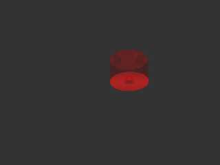

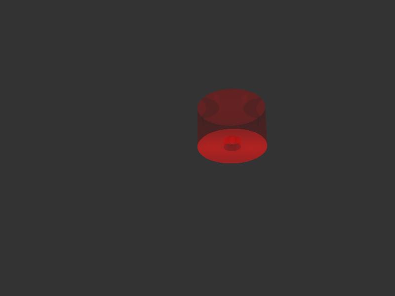

There is a test render at p.b.images
I think it works but don't ask me how good it is for real optics
applications ...

From: TP Electronics
Subject: Re: optic guide.
Date: 10 Jun 2007 09:35:28
Message: <466bfe20$1@news.povray.org>
Yes it is correct.
The close I arrived. with following code:
global_settings {photons { count 20000 autostop 0 jitter .4  } }
camera {location <0, 0,-12.0> look_at 0 angle 30 }
#declare LED_RED=
light_source { <0, 0, 0> color Red    }
#declare  KNOPP=
difference
        cylinder {<0,2,0><0,10,0>,12/2 }
        cylinder {<0,0,0><0,2+1.35,0>,3/2 }
        texture{T_Glass1 } finish {ambient .01 diffuse .9}
background {Gray20}
union
 object { LED_RED translate<6.000000-4.25,00000,6.000000>}
 object { LED_RED translate<6.000000+4.25,00000,6.000000>}
 //cylinder {<0,2,0><0,10,0>,6 texture{T_Glass1 } finish {ambient .01
diffuse .5}
 object { KNOPP translate<6.000000,1.700000,6.000000>}
scale <.1,.1,.1>
rotate <30,0,0>
//End union
