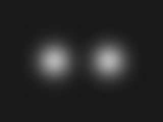

Why is it that when I increase the radius and falloff of a spotlight at
a certain point well before 90 degrees the light appears the same;
version is 3.1g.watcom.win32.  It was my understanding that both radius
and falloff could range up to 90 degrees.
#version 3.1;
global_settings { assumed_gamma 2.2 }
camera {
  location <0, 1, -3>
  look_at  <0, 1, 0>
light_source {
  <-2, 1, 0>
  rgb 1
  spotlight
  point_at <-2, 1, 6>
  radius 60
  tightness 50
  falloff 65
light_source {
  <2, 1, 0>
  rgb 1
  spotlight
  point_at <2, 1, 6>
  radius 30
  tightness 50
  falloff 35
plane {
  z, 6
  hollow on
  pigment { rgb 1 }

I don't see the same thing. Perhaps if you rendered larger you would see a
difference.

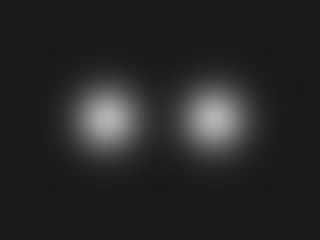

I bumped it up to:
light_source {
  <-2, 1, 0>
  rgb 1
  spotlight
  point_at <-2, 1, 6>
  radius 80
  tightness 50
  falloff 85
light_source {
  <2, 1, 0>
  rgb 1
  spotlight
  point_at <2, 1, 6>
  radius 20
  tightness 50
  falloff 25
A angle difference of 60 degrees!! I rendered it at 640x480 and the
spots on the wall look the same size to me.  What do you see??  I mean
you can simply sketch it out on graph paper and see that a line at 80-85
degrees should hit a lot farther out than a line 20-25 degrees.
As a matter of fact, if I'm not mistaken the radius of a spot at a
distance of 6 units and angle of 20 degrees should be 13.422... units in
radius.  A spot from an angle of 80 degrees at the same distance should
be 54.021... units in radius.

Could be the texture on the plane you're using to shine them on and only
getting a diffuse or specular appearance, not actual illumination.
I know the angle does change the size.  You might want to use 'tightness 0'
to use full broadness of them for this test too.
