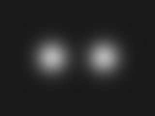

Why is it that when I increase the radius and falloff of a spotlight at
a certain point well before 90 degrees the light appears the same;
version is 3.1g.watcom.win32.  It was my understanding that both radius
and falloff could range up to 90 degrees.
#version 3.1;
global_settings { assumed_gamma 2.2 }
camera {
  location <0, 1, -3>
  look_at  <0, 1, 0>
light_source {
  <-2, 1, 0>
  rgb 1
  spotlight
  point_at <-2, 1, 6>
  radius 60
  tightness 50
  falloff 65
light_source {
  <2, 1, 0>
  rgb 1
  spotlight
  point_at <2, 1, 6>
  radius 30
  tightness 50
  falloff 35
plane {
  z, 6
  hollow on
  pigment { rgb 1 }
Download 'spot.jpg' (2 KB)
Preview of image 'spot.jpg'
From: TonyB
Subject: Re: spotlight radius and falloff
Date: 5 Jan 2000 23:17:52
Message: <38741770@news.povray.org>
I don't see the same thing. Perhaps if you rendered larger you would see a
difference.

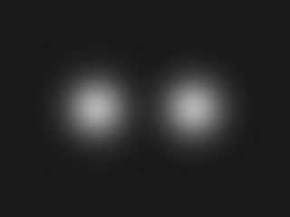

I bumped it up to:
light_source {
  <-2, 1, 0>
  rgb 1
  spotlight
  point_at <-2, 1, 6>
  radius 80
  tightness 50
  falloff 85
light_source {
  <2, 1, 0>
  rgb 1
  spotlight
  point_at <2, 1, 6>
  radius 20
  tightness 50
  falloff 25
A angle difference of 60 degrees!! I rendered it at 640x480 and the
spots on the wall look the same size to me.  What do you see??  I mean
you can simply sketch it out on graph paper and see that a line at 80-85
degrees should hit a lot farther out than a line 20-25 degrees.
As a matter of fact, if I'm not mistaken the radius of a spot at a
distance of 6 units and angle of 20 degrees should be 13.422... units in
radius.  A spot from an angle of 80 degrees at the same distance should
be 54.021... units in radius.
- Jerome
Download 'spot2.jpg' (2 KB)
Preview of image 'spot2.jpg'
From: omniVERSE
Date: 7 Jan 2000 02:44:35
Message: <38759963@news.povray.org>
Could be the texture on the plane you're using to shine them on and only
getting a diffuse or specular appearance, not actual illumination.
I know the angle does change the size.  You might want to use 'tightness 0'
to use full broadness of them for this test too.

From: Jerome Waters
Date: 7 Jan 2000 11:20:47
Message: <3875A242.D9CB6699@mscsoftware.com>
Thanks Bob.
- Jerome
