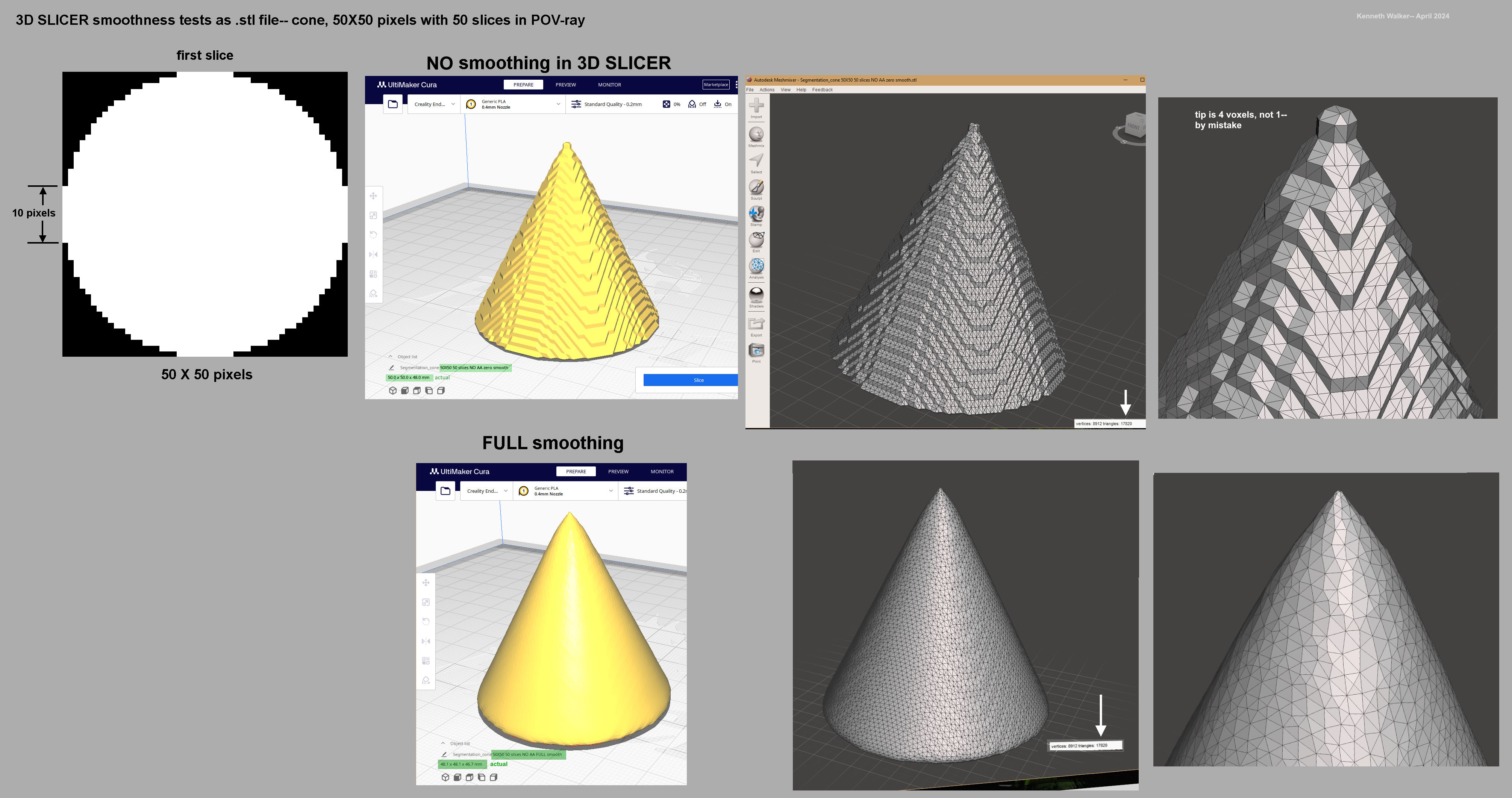

The attached image shows the nature of 3D SLICER's voxel-to-.stl-triangles
construction scheme on an enlarged scale, with and without 'smoothing' used
there. The same number of triangles are created either way.
I purposely sliced a POV-ray cone object at a very *low* resolution, 50 X 50
pixels with 50 slices.  The exported .stl file is shown in Meshmixer and
Ultimaker CURA. Note that on curved exterior surfaces, the voxels join to their
neighbors with a 45-degree tilt of triangles. In my opinion, this is an
advantage-- the surfaces are not simple 'stacked boxes'. With *high*-resolution
image slices, those tilted triangles become so small that even sharp model edges
are retained.
The tip of the cone ended up as four voxels, not one; that was my mistake with
the image resolution I chose. 51X51 pixels would have produced a single-voxel
tip, I think.
This particular cone object illustrates an interesting fact about the slicing
scheme itself, and how it relates to 3D SLICER. In POV-ray, the cone was made
with a 1-unit diameter base and 1 unit tall--- which happens to result in an
exactly cubic bounding box there, behind the scenes. Since it *is* a cube, the
slicing image dimensions and number of slices should be in a 1:1:1 ratio-- for
example,  500X500 rez with 500 slices (assuming the object 'fills the view' in
the renders). POV-ray's messages pane is not really needed to get the proper
ratio in this case-- the result would be a perfectly-proportioned cone due to
the automatic camera in my slicing code.  The same would happen with a sphere--
a cubic bounding box again. This little fact initially confused me as to how the
app was processing the *number* of slices I made-- my test objects had
different-sized b.b.'s with just a few being cubic by chance, and I didn't
realize the significance of the difference at first.  It's fundamentally because
the voxels in 3D SLICER  are 1mm cubes themselves, by default. But most objects
will have an oblong bounding box, not cubic-- which affects the number of slices
required, as each slice represents a single voxel's height. The wrong number
distorts the model.

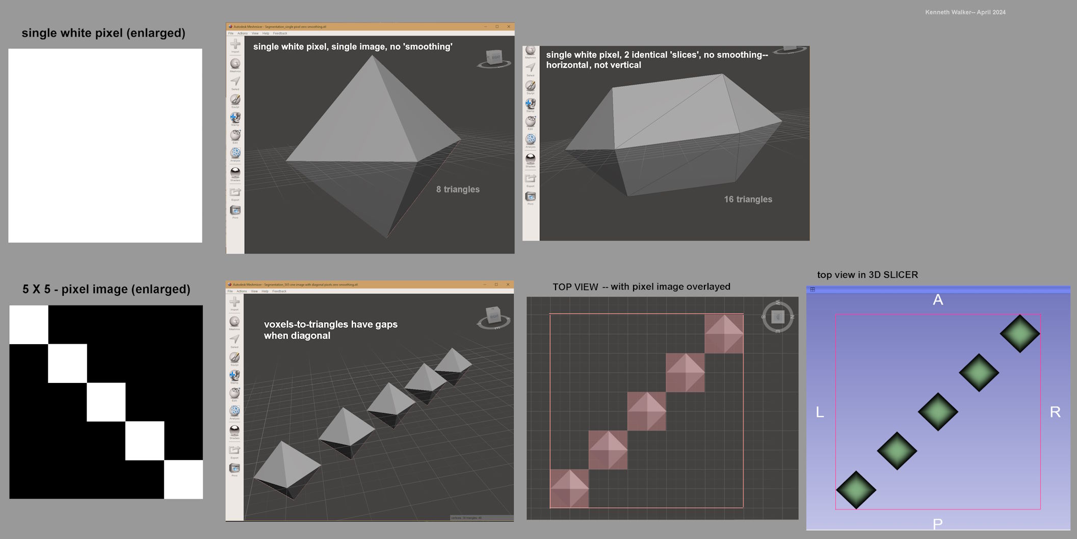

You might be interested in the attached image ;-)
This is what a single 'naked' pixel looks like as a voxel in 3D SLICER, using
zero 'smoothing' there-- actually 8 triangles instead of 4, and rotated 45-deg
around vertical. (I used Meshmixer to view the resulting .stl file.)  The
diamond shape occurs when there are no neighboring voxels to join-up with. To
create it, I made a single 1X1 pixel white image(!) and loaded that into the
app.  (Such a single voxel-as-.stl *can* be 3-D printed, by greatly enlarging it
in the printer's software.)
3D SLICER was apparently never designed to process pure white images or
CT-scans-- this tiny image does not show up there until my STEP 3 instructions
(in 'Segment Editor') are used to 'activate' it and show it as 3-D. (My
slicing code keeps a 1-pixel black border around typical much-larger slice
images, to eliminate this problem.)
A single line of *diagonal* pixels is an oddity-- there are gaps between the
created voxels because of their intrinsic rotated orientations, even though they
do still have a 1:1 size-correspondence with the image...but I wonder how those
gaps affect tiny details in medical CT scans.
And TWO copies of a single-pixel image -- as two 'vertical slices' so to speak--
end up as a horizontal unit of voxels, not vertical as I would have expected.
That is an anomaly in my opinion, but I guess the app's developers had a reason
for designing it with such behavior...or didn't foresee the possibility(?) My
single-pixel 'torture test' is rather extreme though!
Download '3d_slicer_single_pixel_test_kw_4_2024.jpg' (168 KB)
Preview of image '3d_slicer_single_pixel_test_kw_4_2024.jpg'
