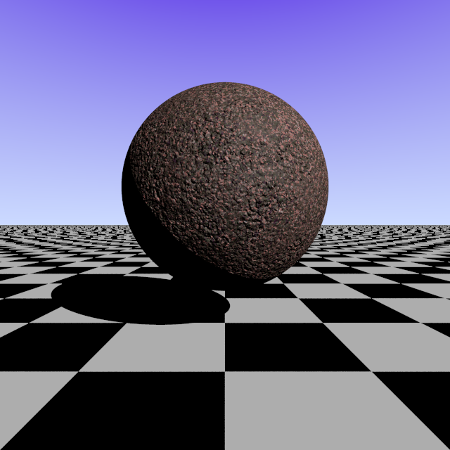

I was looking at using the Dakota Red Granite macro from Thomas de Groot in a
scene that I am working on and found that it generates a material{}.  I had been
under the mistaken notion that you couldn't layer materials, until I read the
details on what they are, which made me happy.
But I started wondering how all of the components of a layered material actually
work and couldn't find a concise explanation.
The pigment part of the texture in a material makes sense to me, and I
understand that the filter/transmit values determine how to mix the texture
starting from the bottom to the top layer.  The other parts are not so clear to
me.
Normals:  Do upper layers add or replace the normal in the lower layer(s)?  It
doesn't seem that pigment transparency would have any effect on mixing the
normals from the various layers.
Finish: Same question, does it add or replace the finish from the lower layers?
If it replaces, does it only replace the elements of the finish not declared in
lower layers, or does it replace the entire finish?  I am pretty sure pigment
transparency doesn't affect this either, or else the standard layering tactic to
make the top layer a completely transparent pigment with the finish you want
wouldn't work.
Interior: This is what just recently occurred to me, and I have no idea what
happens here.  Again, do subsequent interior statements replace prior ones, or
just add what wasn't previously declared?
For most of my interiors I am only concerned with ior, so replacement makes
sense, but what about interior fading and media?
-- Chris R

I started doing some experiments to try and determine empirically how the
layering works.  I did not devise anything yet to test what layered interior
statements do; I focused on the textures part first.
As expected, and explained in documentation, the pigment{} portions of layered
textures are blended together based on filter/transmit settings of the layers
above the base layer.
Normals, also seem to be blended, and it appears the pigment
transparency/filtering is used to determine how to blend them.  I'm not sure how
the implementation works, but possibly the normal is applied to the pigment
first, and then the layers are blended together?
Finish: this is the hairiest one to figure out.
Specular seems to be additive.  I created a solid pigment layer with specular
1.0 and default for everything else.  I created a completely transparent pigment
layer with specular 1.0 and everything else default.  The specular highlight on
the layered object was twice as bright as the highlight on the base-only object.
 It's a little hard to tell what's happening when you have a partially
transparent layer.
I think roughness is somehow combined, but it isn't additive.  Not sure how its
done.
Diffuse seems to be a blend based on the transparency of the upper pigment, but
again, it is a little hard to determine what its doing with my small
experiments.
Reflection seems to be the most confusing.  If the lower layer has no
reflection, and the upper layer has reflection, the whole object has the upper
layer reflection, regardless of the pigment filter/transmit of the upper layer.
However, I did some experiments where the base layer had a reflection of 1, and
the upper layer had a reflection of 0.  In this case, the parts of the base
layer that show through the pigment filter/transmit have reflection, but the
parts of the upper layer that are visible have no reflection.
I haven't looked into things like metallic, crand, etc.
-- Chris R

One note that is causing an issue at the moment:  An identifier for a material{}
cannot be used in a texture_map, and as is well-documented, material_map is not
the same thing at all.
So if, for example, there is a library macro (such as DakotaRedGranite) that
returns a material, rather than a texture, it cannot be used in a patterned
texture.
In my particular use case, I was hoping to have an object that is partially
polished, and partially unpolished, as if the polish had worn away in some
places, but there is no way to "unpack" the texture from the material, so I will
have to take the macro code and modify it to return a texture instead of a
material if I want to do this.
-- Chris R

Subject: Re: Details on layered textures/materials
Date: 2 Apr 2024 11:28:57
Message: <660c2439@news.povray.org>
Op 1-4-2024 om 19:20 schreef Chris R:
> I will start with the parsing errors I ran into with my initial transformation.
First comment:
I think that the necessity to explicitly /declare/ the texture of the
Crand() macro comes from the fact that the material{} envelop has been
dropped. So, it seems that in order to enable the layered texture built,
the Crand() macro needs to be put /inside/ a texture declaration, as you
did.
Second comment:
Your macro version works fine but you can simplify the output in the
following way. Instead of:
> #macro DakotaRedGranite(CSC, Pol, Typ, Pat1, Pat2, Blend, SS)
>      #local _m   = material {
>          texture { DakotaRedGranite_texture(CSC, Pol, Typ, Pat1,
> Pat2, Blend, SS) }
>          interior { ior 1.6 }
>      _m
> #end
you can simply write:
         texture { DakotaRedGranite_texture(CSC, Pol, Typ, Pat1, Pat2,
Blend, SS) }
#end
And then apply the macro in a scene, in the following way if you
need/want to wrap the texture in a material{} declaration:
// sample sphere
sphere { <0,0,0>, 1.00
   material {
     DakotaRedGranite (CSC, Pol, Typ, Pat1, Pat2, Blend, SS)
   scale<1,1,1>  rotate<0,0,0>  translate<0,1.35,0>
}  // end of sphere -----------------------------------
The macro returns a texture{} which can be then be used as such in any
scene.
Bill will note other issues or improvements I am sure. ;-)
Download 'chrisr_test.png' (197 KB)
Preview of image 'chrisr_test.png'
