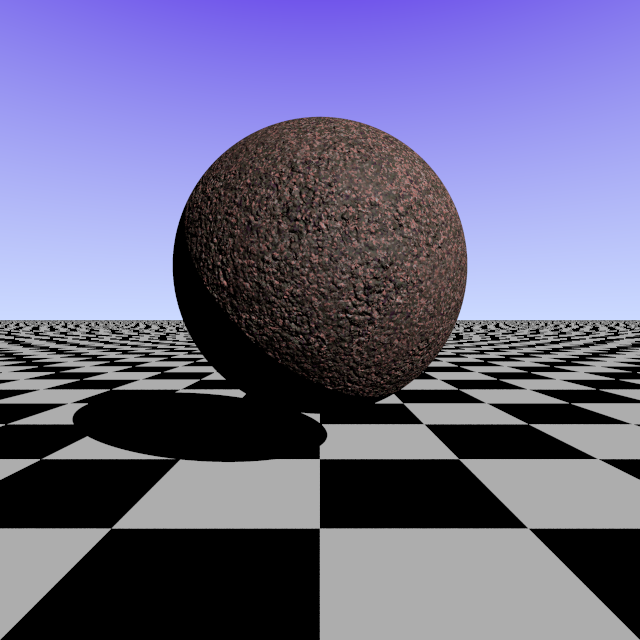

Op 1-4-2024 om 19:20 schreef Chris R:
> I will start with the parsing errors I ran into with my initial transformation.
First comment:
I think that the necessity to explicitly /declare/ the texture of the
Crand() macro comes from the fact that the material{} envelop has been
dropped. So, it seems that in order to enable the layered texture built,
the Crand() macro needs to be put /inside/ a texture declaration, as you
did.
Second comment:
Your macro version works fine but you can simplify the output in the
following way. Instead of:
> #macro DakotaRedGranite(CSC, Pol, Typ, Pat1, Pat2, Blend, SS)
>      #local _m   = material {
>          texture { DakotaRedGranite_texture(CSC, Pol, Typ, Pat1,
> Pat2, Blend, SS) }
>          interior { ior 1.6 }
>      _m
> #end
you can simply write:
         texture { DakotaRedGranite_texture(CSC, Pol, Typ, Pat1, Pat2,
Blend, SS) }
#end
And then apply the macro in a scene, in the following way if you
need/want to wrap the texture in a material{} declaration:
// sample sphere
sphere { <0,0,0>, 1.00
   material {
     DakotaRedGranite (CSC, Pol, Typ, Pat1, Pat2, Blend, SS)
   scale<1,1,1>  rotate<0,0,0>  translate<0,1.35,0>
}  // end of sphere -----------------------------------
The macro returns a texture{} which can be then be used as such in any
scene.
Bill will note other issues or improvements I am sure. ;-)
Download 'chrisr_test.png' (197 KB)
Preview of image 'chrisr_test.png'
Subject: Re: Details on layered textures/materials
Date: 3 Apr 2024 03:17:56
Message: <660d02a4$1@news.povray.org>
Op 2-4-2024 om 17:28 schreef Thomas de Groot:
> Blend, SS) }
> #end
NOTE==> even better: you can completely skip this particular macro
definition!
// sample sphere
   material {
     texture { DakotaRedGranite_texture (CSC, Pol, Typ, Pat1, Pat2,
Blend, SS) }
As your granite macro version generates a texture{}, it can be used as
such in a scene.
[ still valid ;-)  ]
