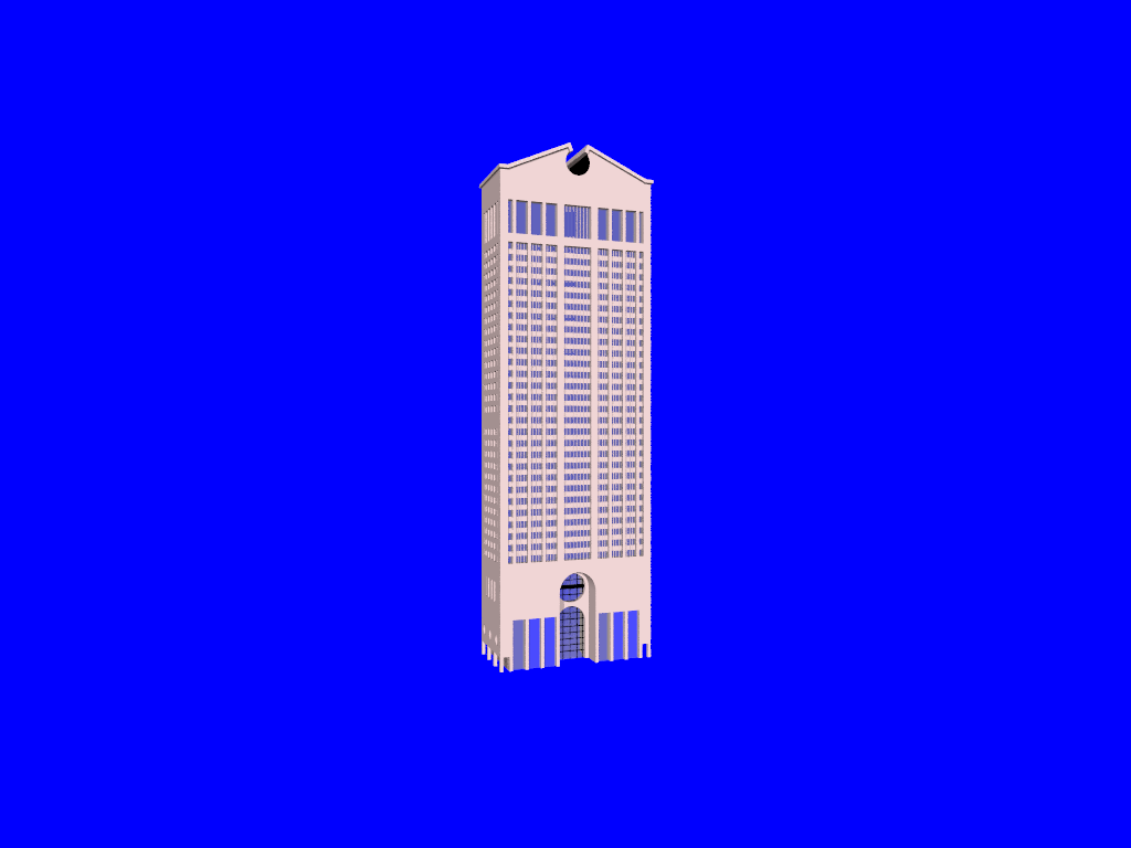

From: David Kraics
Subject: Re: Image_map question
Date: 4 Dec 2023 20:10:00
Message: <web.656e779a4becaf926633439fa57e0@news.povray.org>
I thank everyone for their suggestions. I finished the project. The final
building  is attached.
Download 'prototype2.png' (96 KB)
Preview of image 'prototype2.png'
