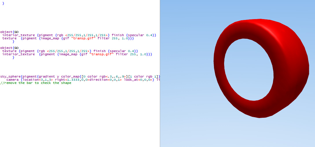

Bug hacked?
old sprites concept? I'm under no illusions, I'll do more tests, but in this way
I don't see the bug anymore
Download 'clipboard01.jpg' (122 KB)
Preview of image 'clipboard01.jpg'

WOW!
right no trick
left the concept ... SHAPE-in-out XOR SWAPSHAPE-out-in
Download 'clipboard01.png' (198 KB)
Preview of image 'clipboard01.png'

Even better :
interior_texture{pigment{rgbt 1}}
or
interior_texture{pigment{rgbf 1}}
That way, no need to use any image file.

Well , I will check... anyway the gif image is only a transparence...
but I call the object twice, swapping inside/outside
Do you mean the same thing? To understand I would have to see your code on
pigments
TX!
G.

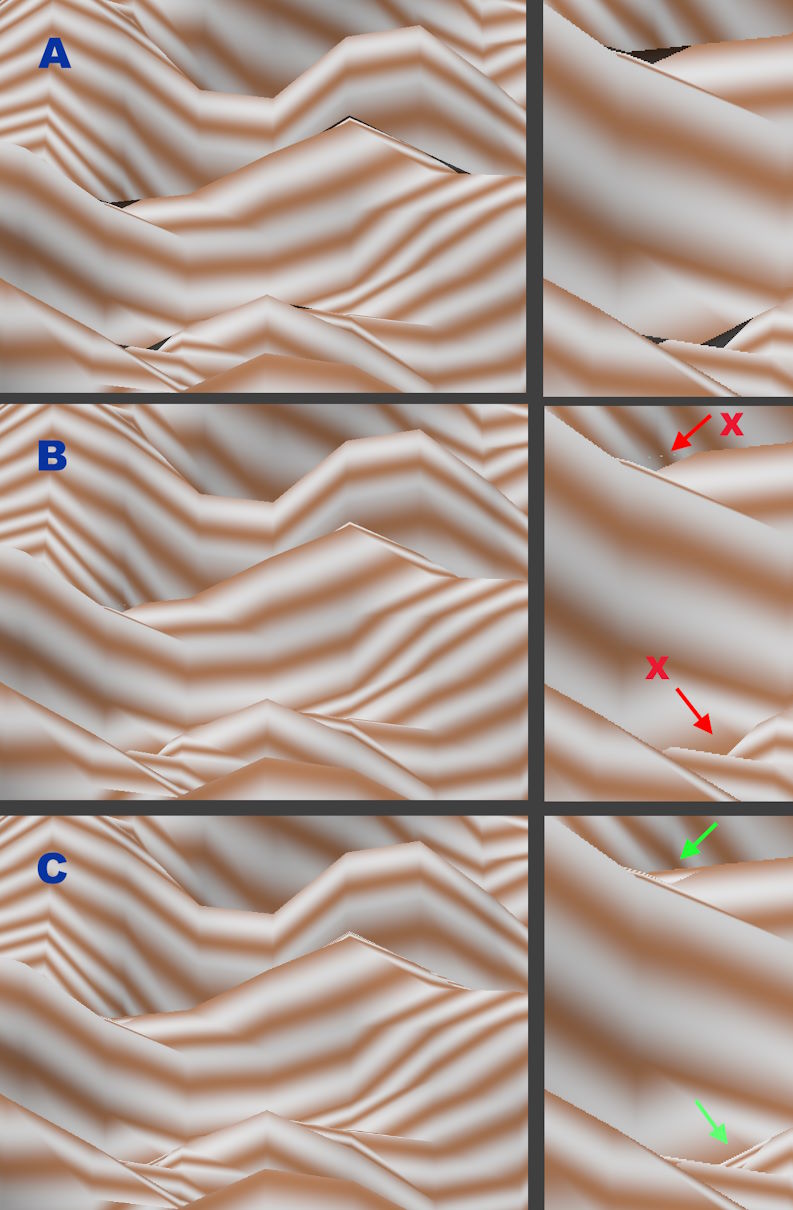

Using a transparent texture like that is very clever! However, it actually
*removes* the offending triangles... that is, it makes them invisible (if that
matters.) I had to test it to see. You might want to examine your renders to see
if that happened.
The attached image is my height_field again; close-ups are on the right side:
A-- the artifacts
B-- with    interior_texture{pigment{rgbt 1}}.  The artifact triangles are
missing (invisible).
C-- with    interior_texture{-- same as exterior--}
but with   finish{--ambient or emission value--} to try to match it.
The triangles are visible.
The scheme of using the same interior_texture as the outer one still looks
better, to my eyes.
[code taken from your image]
object{GO
interior_texture{pigment{rgb...}...
texture{pigment{image_map{gif "transp_GIF".gif...  [or  pigment{rgbt 1} ]
Although this scheme might appear to work for your model, it has a  problem: The
interior_texture is the 'real' one, but it does not respond to the usual
'exterior' lighting in a scene because it is actually on the INSIDE  surface of
the mesh. Only ambient or emission in its finish{...} is of any use, which does
not look very good-- at least for  my own height_field.
Download 'artifact_comparison_kw.jpg' (129 KB)

Unfortunately I noticed that my system still has artifacts that I didn't see.
However, I noticed that in my test models they are less evident because those on
the edges of the shape generally disappear (which I believe are faces tangential
to the vector starting from the point of view). I haven't tried playing with f
and t yet... I'll try tomorrow. Now I'm importing colors from STL to bring them
grouped onto distinct meshes
Thx!
G.

Just something like this :
First instance become
interior_texture{pigment{ Something }}
The other become
