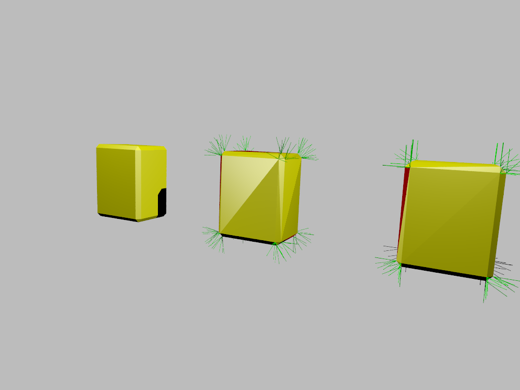

tx Bw
I am working around this concept. The bad angle is 90 degrees. The vectors are
ever long 1 (red color), so the distance (green) it's approximately 1,4142
(Pitagora).
Around this value I have to eliminate the smoothing. It involves graduating on
the size of the angles. Unfortunately I don't have much training in
trigonometry... it takes me a long time and I don't know the shortcuts in the
formulas, I need time...
TX Again
G.

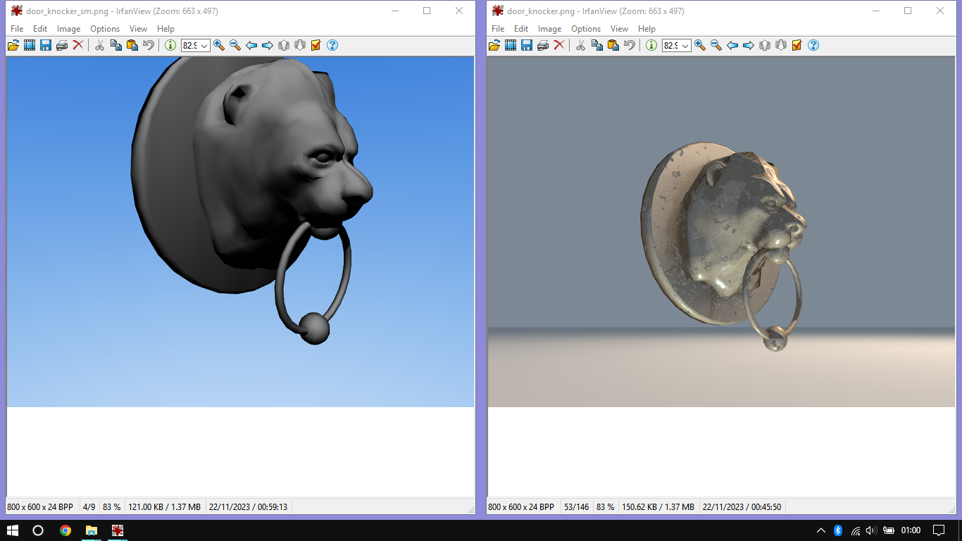

From: GioSeregni
Subject: Re: Smooth level for smooth_triangle.
Date: 21 Nov 2023 19:30:00
Message: <web.655d4ae484c692a3276109cb59126100@news.povray.org>
There was an interesting comment with a utility to download, but now I don't see
it anymore. Has it been cancelled? I took the obj and converted it to STL then
applied my code to it, but without refinements in the environment. I tested his
example with my program, because I had downloaded it, my render is poor.. it has
no texture, it has no lights... I put the linked example but rendered with my
version 3.7 (the file was 3.8 ) Strange, I can no longer find who posted and the
content, thanks anyway!

Luckily, I had written a fully chamfered box macro not too long ago, so I could
just piggyback off of that and get right to trying to calculate the normals and
replicate the work in that first paper.
I normalize all of my cross-product vectors before summing to get the "wrong
way" and then just use the direct cross-product result to try to get the
right/improved way - but it still doesn't look very smooth.  So I must have some
aspect of this that I didn't code right in that second macro.
(and even seeing the flaws is very lighting and camera angle dependent...)
However, aside from that, what I did find disturbing is that I have an
interior_texture defined for my smooth_triangles, and that's showing up, even
though my normals are facing the proper way.
So it seems like we're back to having some triangle mesh rendering errors in the
source, even after clipka hunted down and fixed the faux-mesh union-of-triangles
problem that I uncovered when making subdivided spheres.
See attached.
Maybe someone else can confirm.
- BW
