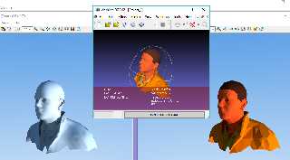

My code is already working from STL to POV even with the color subset of STL.
In fact I have to add the surface calculation to the loops from triangle to
smooth_triangle, I'll take a look at your system. But first I also want to
translate the color, as I already do with the triangles, dividing groups of
differently colored meshes. This way my translator will also become faster
because the loops are compact and short on small meshes.
(between different colors I don't want smooth).
In the center STL, on the left the current smooth routine, on the right the
simple triangle mesh. Thank you!
Download 'clipboard01.png' (158 KB)
Preview of image 'clipboard01.png'

I May be wrong but I don't believe the normals length will be taken into account
at all. I believe they are rather always 'normalized' (no pun) to a value of 1
and just their directions used. Some of the most valuable input may be from
Alain with all his technical POV knowledge. the only things that then would
change the apparent curvature of normals *globally* is the 'brilliance' keyword
value or more locally the slope normal pattern... but again all this needs to be
verified.
