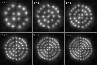

>    4, 4                // total number of lights in grid (4x*4z = 16
> lights)
That's a small array.
>    adaptive 0          // 0,1,2,3...
And using adaptive with it gives almost no benefit. With that adaptive
value, you can use a 33 by 33 array with almost no performance hit.
>    jitter              // adds random softening of light
ESSENTIAL with such a small array
>    circular            // make the shape of the light circular
>    orient              // orient light
Make the light act as a spherical light source. This makes the
orientation of the array irrelevant, just setting the extant of the light.
>    translate <40, 80, -40>   // <x y z> position of light

On 2023-01-25 12:22 (-4), Alain Martel wrote:
> Any sampling array size between those values will be silently increased
> to the following size of the list. A 4 x 4 adaptive is really 5 x 5, 6 x
> 6 is promoted to 9 x 9 and 10 x 10 become 17 x 17.
Not according to my tests.  The attached images were rendered with
area_illumination to reveal the internal array of lights.
Download 'circular_light-20230126.jpg' (72 KB)
Preview of image 'circular_light-20230126.jpg'
Probable complications - as best my glitchy memory serves...  :-)
area_illumination essentially walks through each of the area light
positions - more or less - as originally specified; tracing each are
position in turn and coming up with a final, weight adjusted, result.
Any adaptive bits (for shadow rays only) and circular bits run at each
of the area light's effectively moving 'center' positions with
area_illumination on.
The adaptive mechanism being discussed in this thread comes into play
only during shadow ray tracing.
The circular option itself introduces some bias in the counts and
position of the area lights as the rectangular specification gets mapped
to a circular one.
--- Other misc.
There is an open github issue on the circular option occasionally
introducing visible bias in lighting results.
https://github.com/POV-Ray/povray/issues/222
There is too this open github issue related specifically to
area_illumination and adaptive/circular shadow calculations not playing
well together:
https://github.com/POV-Ray/povray/issues/224
I believe these github issues still unsorted in any available POV-Ray or
branch/patch release.
Bill P.
So, shining an area_light with adaptive AND area_illumination thru a
small opening changes how adaptive work. Interesting.
Did you try without area_illumination ?
