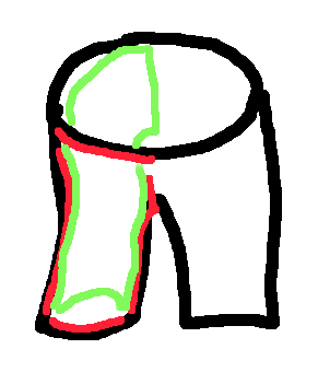

Greg, I think it may be doable with one of the macro's in my mesh
generation package http://code.google.com/p/mmgm/ or Tor-Olavs NURBS
macro's. All depends on how you brake down the trousers in a few basic
shapes that can be defined by four splines that you then stich together.
I'll try to describe the brake down: one spline defines the outer seam of
the trousers, at the lower end connected to a half circle spline for the
"foot hole". The top of de seam sline is connected to a quarter circle
that is the belt section of the trousers. Last spline would be the inner
seam. These four splines define a surface that form a quarter of the
trousers.
ingo

From: ingo
Subject: Re: To Mike Williams: is a four-hole SweepMesh.inc possible?
Date: 26 Sep 2010 05:43:34
Message: <Xns9DFF77493C69seed7@news.povray.org>
in news:web.4c9de1639b1fb69134d207310@news.povray.org gregjohn wrote:
> ingo, thanks for thinking this through with me.  First of all upon
> looking at your google code site (but not yet d/ling any files) I'm
> wondering which include or routine it would be.
Greg, it's been a while since I wrote and used the thing, so I had to look
for my self. The multi spline mesh seems the best candidate to create one
half of the trousers. Define the green and red splines in the attached
image. The mesh package is fully documented and has examples.
> I've got a macro where I modified Mike's code to take any arbitrary
> sectioning shape-- superellipsoid, cube, squashed cylinder-- instead
> of a circle, as it creates the mesh along the backbone.
Writing a macro for Lofting / extruding a pair of trousers ie splitting a
path (backbone) to go in different dirction isn't easy.
Download 'pantssplines.png' (5 KB)
Preview of image 'pantssplines.png'
From: gregjohn
Date: 28 Sep 2010 12:35:00
Message: <web.4ca218409b1fb691a00085090@news.povray.org>
Thanks. I've posted to p.b.i. an image which is an attempt to try your
four-point coons.inc on the problem of pants.  I think that the coons include
will be more useful than the MMGM.  I'm also wondering if I should try a
six-point or eight-point modification of your macro to try and get the geometry
just right.
