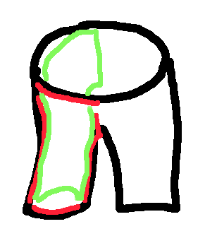

From: ingo
Subject: Re: To Mike Williams: is a four-hole SweepMesh.inc possible?
Date: 26 Sep 2010 05:43:34
Message: <Xns9DFF77493C69seed7@news.povray.org>
in news:web.4c9de1639b1fb69134d207310@news.povray.org gregjohn wrote:
> ingo, thanks for thinking this through with me.  First of all upon
> looking at your google code site (but not yet d/ling any files) I'm
> wondering which include or routine it would be.
Greg, it's been a while since I wrote and used the thing, so I had to look
for my self. The multi spline mesh seems the best candidate to create one
half of the trousers. Define the green and red splines in the attached
image. The mesh package is fully documented and has examples.
> I've got a macro where I modified Mike's code to take any arbitrary
> sectioning shape-- superellipsoid, cube, squashed cylinder-- instead
> of a circle, as it creates the mesh along the backbone.
Writing a macro for Lofting / extruding a pair of trousers ie splitting a
path (backbone) to go in different dirction isn't easy.
Download 'pantssplines.png' (5 KB)
Preview of image 'pantssplines.png'
From: gregjohn
Date: 28 Sep 2010 12:35:00
Message: <web.4ca218409b1fb691a00085090@news.povray.org>
Thanks. I've posted to p.b.i. an image which is an attempt to try your
four-point coons.inc on the problem of pants.  I think that the coons include
will be more useful than the MMGM.  I'm also wondering if I should try a
six-point or eight-point modification of your macro to try and get the geometry
just right.
