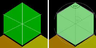

From: Kenneth
Subject: Re: Precision problems?
Date: 26 Jan 2024 12:30:00
Message: <web.65b3eba7284cb76f9b4924336e066e29@news.povray.org>
"Cousin Ricky" <rickysttATyahooDOTcom> wrote:
> Ilya Razmanov <ily### [at] gmailcom> wrote:
> > I'm out of ideas regarding the cause of it. Any inspiration?
> The geometry of the hexagons is off.
Yes, that was my guess--although, I didn't know exactly why, so I started
measuring the render visually. The white lines connecting the points should be
equal lengths but are not.
I also superimposed a hexagon diagram from Wikipedia; it shows that the internal
angles are off a bit.
Download 'hexagon_examples_kw.jpg' (60 KB)
Preview of image 'hexagon_examples_kw.jpg'

Thanks for illustration. As "Cousin Ricky" explained, I messed internal
and external diameters in some cases. That is, the values were correct
but these were correct values of *another* variable. How foolish of me.
Ilya.
