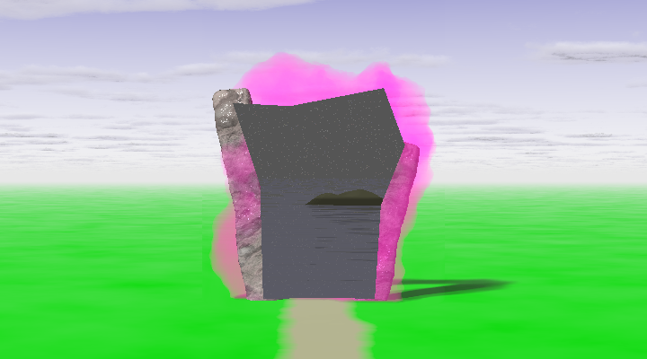

The first attachment shows the basic scene, where I've built the mesh
and what it's looking at. The second attachment shows the results of
using the mesh with distribution 0. The cylinder is diagonal and repeated.

I found the mistake that is causing the skewed image. I forgot the end
condition on a FOR loop will can the end value of the loop, so I was
calculating one extra pixel per row, which the mesh camera dutifully
pushed to the next row, so my original code was generating more
triangles than needed.
Live and learn.
Well ... live.
Josh

From: Josh English
Subject: Re: Not grokking mesh camera
Date: 8 May 2023 11:29:44
Message: <64591568$1@news.povray.org>
On 5/8/2023 5:53 AM, jr wrote:
> hi,
> "Bald Eagle" <cre### [at] netscapenet> wrote:
> yes.  as written, that is starting with stuff copied + modified from the
> distribution mesh_cam scene/inc, there isn't really a good way of picking a
> subset (of triangles) to treat separately.  (will put together an email, later
> or tomorrow)
Actually, I've been playing with that, too, but the image is not so
great because I'm a crappy modeller. This technique is based of Jaime's
macros. I've been directly calculation the location of each spline out
of stubbornness. Jaime relies on the trace function, which means you can
filter the triangles with an object. I think his method using trace is
superior to mine. I had to reinvent some wheels to get to a point of
understanding, though.
In the attached image the sky and clouds and "grass" are all fairly
normal (the "grass" is a plane at y=0), but the attempt at a starry
water scene is actually sitting at y=-20.
Cheers.
Download 'portal_test.png' (153 KB)
Preview of image 'portal_test.png'
