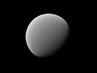

From: "Jérôme M. Berger"
Subject: Re: Media, Intervals, samples and getting results
Date: 3 Jan 2005 17:29:02
Message: <41d9c72e$1@news.povray.org>
Hash: SHA1
Jellby wrote:
| According to this, more samples -> brighter media.
	That is correct. If you push this to the extreme, you'll get this
image (10 samples):
http://jeberger.free.fr/mpov/sphere_bl.png
	Increasing the number of samples (to 200) gives this one:
http://jeberger.free.fr/mpov/sphere_no.png
| But I see the opposite,
| as if the influence of the samples was "averaged" (since most
samples are
| deep inside, the effect of the surface ones is weaker). I would have
| thought that the sampling algorithm (and colour calculation) would be
| smarter than that, but maybe that's not so easy...
	Do you have a sample code that produces this effect?

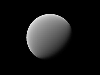

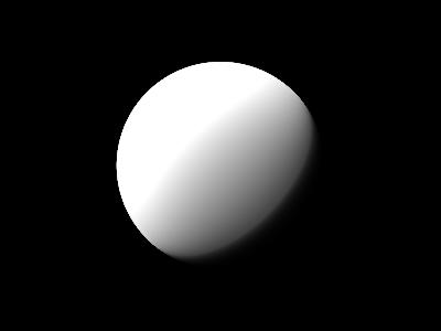

From: Jellby
Date: 3 Jan 2005 18:25:53
Message: <41d9d47f@news.povray.org>
Among other things, "Jérôme M. Berger" saw fit to write:
> samples are
Yep, try this (povray 3.6.1, custom compile):
camera { location <0, 0, -10> look_at 0 }
light_source { <-20, 20, -20>, rgb 1 }
sphere {
  0, 3
  hollow
  pigment { color transmit 1 }
  interior {
    media {
      scattering { 5, rgb 3 }
      method 3
      intervals 1
      samples 10 // try also with 200
I've attached two images: "test1" has samples 10, "test2" has samples 200.

In my experiments, I did not see any significant difference in the output by
fiddling with aa. According to your explanation, "samples 10 aa_level 8
aa_threshold 0.0001" should give similar results to "samples 160 aa_level 4
aa_threshold 0.0001", and I don't see that with the above example. Could
you give a more clear example?
> Note that this only applies to subsurface scattering simulations: eg
> in cases when you have a very dense nearly uniform media.
Yes, my experiments are confined to uniform media. I wonder if this adaptive
sampling and antialiasing is only valid for non-uniform media (opposite to
your sentence above), maybe uniform media makes adaptive sampling
unnecessary...
Or maybe I'm making some mistakes.
I would guess that what is happening is in test1, the first sample of a ray
is well lit and the other 9 are poorly lit or dark (due to self shadowing).
While in test2, the first sample is well lit and the other 199 are poorly
lit or dark. So the percentage of lit samples in the first is much greater,
causing it to be significantly brighter. This is only happening because the
media is so dense that it becomes dark at a very shallow level.
I would assume that the greater number of samples is producing the more
accurate result.
One thing to try: make two nested spheres, the inner one about 4/5 the
diameter of the outer one. Give them the same media, but give the outer one
much more samples. Then the edge of the media (in the outer sphere) will be
well sampled - as it needs to be to avoid this problem, but the inside of
the media (the inner sphere) will be poorly sampled, which is ok since it's
all dark in there anyway. If this works, it may be the fastest way to get
the effect with accuracy. (Be sure, of course, to avoid having the sphere's
volume's overlap (use a difference on the outer sphere to do this), and to
avoid coincident surfaces.)
> ray is well lit and the other 9 are poorly lit or dark (due to self
> shadowing). While in test2, the first sample is well lit and the other 199
> are poorly lit or dark. So the percentage of lit samples in the first is
> much greater, causing it to be significantly brighter. This is only
> happening because the media is so dense that it becomes dark at a very
> shallow level.
> accurate result.
That was my impression and that could be the reason. There's little
difference between "samples 200" and "samples 2000"
> one much more samples. Then the edge of the media (in the outer sphere)
> will be well sampled - as it needs to be to avoid this problem, but the
> inside of the media (the inner sphere) will be poorly sampled, which is ok
> since it's all dark in there anyway. If this works, it may be the fastest
> way to get the effect with accuracy. (Be sure, of course, to avoid having
> the sphere's volume's overlap (use a difference on the outer sphere to do
> this), and to avoid coincident surfaces.)
Hmm... It didn't seem to be quicker in this case, the effect of the samples
was very similar and the inner surface was visible (in fact, the inner
media didn't have much influence).
I guess it's best to have as few samples as possible, as long as there are
enough to accurately sample the media (i.e. the appearance doesn't change
much with increasing samples)

	Like Slime said, you'd need to have aa_threshold set to 0 to get the
same results (if pov accepted). You can however get the same effect
by using a ridiculously small value. Moreover I wrote a little too
fast yesterday: the precise formula is (min_samples-1) * 2^aa_level +
1, assuming of course that min_samples is at least 3.
adaptive
(opposite to
| unnecessary...
	It looks like povray does some optimizations in the case of a
constant density media. I did a quick check by adding the following
density to your code:
density {
~  spherical
~  color_map {
~    [ 0.0 rgb 1.0 ]
~    [ 1.0 rgb 1.0 ]
	Since the colormap is rgb 1.0 everywhere, this should give the same
results as the original but it doesn't. The result is pretty much
what I described in my previous post (except that samples 129 takes
much longer to render since there are a lot of pure black samples
taken that get culled in the samples 3 case). You may take a look for
example at those pictures done with aa_threshold 1e-200:
aa_level 8
samples 3
http://jeberger.free.fr/tmp/media-3-8.png
aa_level 2
samples 129
http://jeberger.free.fr/tmp/media-129-2.png
	I'd say that this is a bug.
	Note that you can probably get the correct result with a faster
render time if you disable this optimization by adding a pseudo
density like I just did...
		Jerome
PS: If the pictures aren't there, try again a bit later: as of this
posting, the second one hadn't finished rendering...

Which POV-Ray version and platform are you using? I could not reproduce your
results, I got quite the same effect I was getting with constant density:
overbright media with "aa_level 8 samples 3" even if I introduce a slope in
the color_map (then the media is different, of course, but still not
similar when the samples and aa_level are varied).
