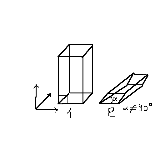

From: eric
Subject: Re: inclined Prism ?
Date: 25 Aug 1999 17:03:18
Message: <37c45a16@news.povray.org>
I need bevelled prisms...
To explain what I mean:If you have a regular cube, it's a kind of prism with
orthogonal edges. If I rotate it, it still have orthogonal edges.
What I need is an extrusion  with non-orthogonal to base vector. (See my
beautiful picture.. I need (2), and not (1) ..)
Perhaps there is a simple way to achieve this lkind of frame... ?
Of course, I could use CSG Differences to cut a regular prism with a rotated
cube to obtain a bevelled prism.. but well, it would be very fastidious in
my case...
Chris Huff wrote in message <37C327F8.F7FE8E00@compuserve.com>...
>What is wrong with simply rotating the prism?
Download 'Image1.gif' (4 KB)
Preview of image 'Image1.gif'
From: Ken
Date: 25 Aug 1999 17:20:13
Message: <37C45DD8.2D7F817C@pacbell.net>
> my case...
A rotational sheering operation make this a snap:
camera{location<-0.75,0,-3> look_at 0}
light_source{<-100,10,-200>rgb 1}
     box { -.5,.5
           rotate 20*-z
           scale<1,.5,1>
           rotate 10*z
 pigment { rgb 1 }
Ken Tyler

From: Josh English
Date: 26 Aug 1999 16:23:01
Message: <37C5A245.F9782956@spiritone.com>
Everyone is suggesting the Matrix transformation, but I assume you mean the
"leaning tower" of Pisa, Italy? That tower was built straight up, only a huge
architectural screw up caused it ot lean as it's foundation began to sink on one
side, so a standard prism rotated should do the trick.... but to get the effects
of the diagram, yeah, go for matrix
