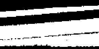

Well, I was playing around in pov, using rand() and seed() functions
when I found this little effect after using it a bit.
The original idea was to ues the Superpatch in a few aspects(place a lot
of sphres and use bouded_by from a text object, and thus get text made
out of bubbles, generally.) when this effetc appeared, I made some
changes, and switched to normal pov to see if it was still there. Sure
it was.
Well, this is the code for the scene :
camera { location<0,0,-10> look_at<0,0,0> }
light_source { <-50,150,-50> color rgb 1 }
light_source { <+50,150,-50> color rgb 1 }
union {
  #local Min = <0,-0.0286, 0>+0.1;
  #local Max = <10,1.6721,4.6715>-0.1;
  #local S = <seed(1), seed(2), seed(3)>;
  #local R = seed(4);
  #local N = 0;
  #while(N<10000)
    sphere {
      Min+(<rand(S.x),rand(S.y),rand(S.z)>*Max)
      (rand(R)*0.07)+0.03
    #local N=N+1;
  #end
  translate -5*x
  pigment {colour rgb 1 }
  finish {ambient .8}
At first I thought it was the #local S = <seed(1), seed(2), seed(3)>;
line that was in error, but no. This worked with other numbers, so the
error is in seed(1) seed(2) seed(3) generation.
I just wonder if there is a limitation in the seed() function causing it
not to work with theese small numbers ???
If i used a a larger set of numbers, 666, 1999, 2010 3010 and so, it
worked nicely, but not here.
Attached is a .gif of the image, 2 colours.
I'm sorry about the image, but I thought it was small enough to be
attached here. *smile*
//Spider
Download 'bug_2.gif' (1 KB)
Preview of image 'bug_2.gif'

It happens with every series of seeds with regular intervals.
I tried it for instance with 1000,2000,3000 which gave a similar result. Then I
tried it with 1000,2001,3000 and lo and behold!
I gues this has something to do with the way seed() works but I wouldn't know
anything about that.
What I don't understand is why you should declare more then one seeds.
Isn't one enough? Anyway, look what happens when you use only one seed. I did
I guess this isn't really a bug, just a way to uncover that randomness in a
computer is often pseudo (as you mentioned).
ok, is that it. I guess i should have known :-) (After all, I'm
currently reading a thing on how to make pseudo random values, abd how
to prove that a random series isn't working with statistics...)
oki.
probably not the seed() but the rand().
Actually, I usually have one for each axis, because then there is less
difference If i add a random rotation around an axis or so. And, I think
it's better to use three random values instead of one, gives me a bit
better feeling about it, it's "more random" (I know I'm wrong, but,
whata heck :-)
yup. I was just baffeld at the experience... (notice the ? in the header
//Spider
