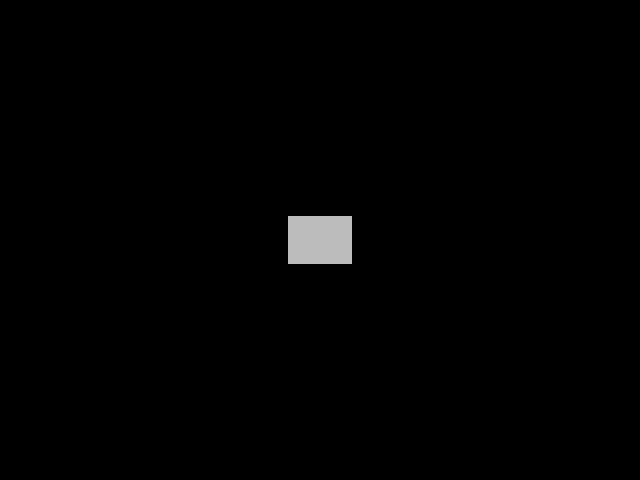

Just briefly scanning this over (as I was up late making rapid-fire changes) and
I noticed that the parser allowed and didn't complain about:
#local in2 = #local Result = {EcResult [2], EcResult [4]};
So who know what other wacky constructs it will let slip through.
Anyway, fixing 2 such statements allowed me to render this stunning grey
rectangle, which I'm assuming must be my cylinder.
- BW

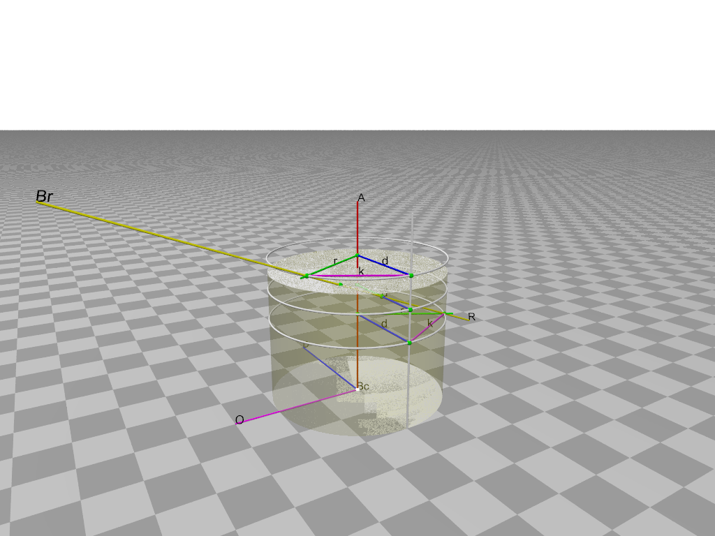

Seeing how exciting that last post was, let me now slay you with a diagram of
what's going on in that paper.
Download 'graphicsgemslinecylinderintersection.png' (195 KB)
