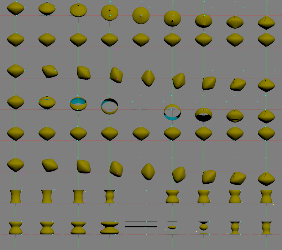

I initially did leave the textures attached to the objects when first doing the
differences, but my code is such that it was easy to leave them textureless for
use with cutaway_textures, so no, that doesn't appear to be the problem.
Will post the scene file when I get out of here in an hour.
With regard to c_t not using interior_texture, that seems to be a reasonably
expected behaviour, and one which I'd have to think hard about how to code a
workaround for.
I also had that recent scene where I was getting washed-out colors, and I really
don't believe that I have any overlapping objects, however I will have to make a
detailed check to be absolutely sure.
- BW

using
3.8.0-beta.2+gh7.msvc14.win64
scene file attached
Download 'sor permutations.pov.txt' (6 KB)

Attached an image of some more testing. It includes the fix for the
segment blink out issue & that fix looks good thus far. For testing I
disabled all the point list sanity checking to see what works and not.
Not going to go through the image in detail, but in answer to your
question about on curve points going negative it looks like a no go
without a deep dive and probable re-work of the current code.
For reasons I don't understand, when I allow on curve points to go
negative the camera ray direction affects results. This shown in the
fourth row where the sor slowly disappears then reappears as rotated
about x.
The descending in y on curve points doesn't work at all.
Allowing the first and last control points to go negative is fine and I
plan to add that relaxing to the blank out fix for yuqk's next release.
You had mentioned not being able to flip the two control points in y.
Where everything I'd tried to that point seemed to work. You also
mentioned this bit of code in sor.cpp :
if ((fabs(P[i+2][Y] - P[i][Y]) < gkMinIsectDepthReturned) ||
     (fabs(P[i+3][Y] - P[i+1][Y]) < gkMinIsectDepthReturned))
throw POV_EXCEPTION_STRING("Incorrect point in surface of revolution.");
I'm finding it is this run time check which sometimes doesn't allow
control points flipping in y. For yuqk what will be in the next release
is some added error text when that check trips so it is easier to
understand what is wrong.
Error! Problem point in sor segment 0 point set.
fabs(P[2][Y] - P[0][Y] || fabs(P[3][Y] - P[1][Y])
fabs(0.5 - 0.5 || fabs(0.9 - 0) < 4.44089e-08
The center images in the bottom two rows(*) of the attached image trip
this check and error. So, that code is catching some 'particular' cases
where given the control point locations relative to other on curve
points doesn't render correctly.
(*) Those rows are start the control points at one extreme and slowly
flip them to the opposite extreme in y moving left to right in the lower
two rows.
So with the segment blink out fix, it does look like more could be
allowed as valid point sets for the sor & yuqk will adopt those
relaxations. The shapes with negative control points do break up more
often, but as we found this can happen today with certain point lists.
(I've not really looked at intersections and differences as yet)
Bill P.
Aside: Somewhere I should mentioned too that that blink out fix corrects
the blink out, but in certain cases it also slightly corrects bounding
cylinders where due how min/max work there was no blink out. In other
words some fringe fixes/differences might appear too due the blink out fix.
