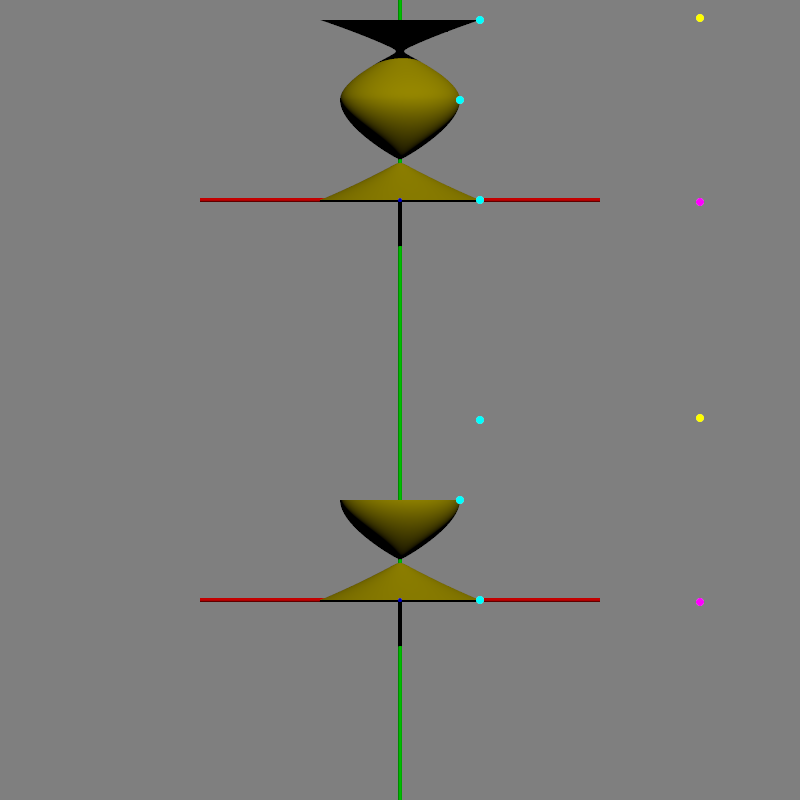

Well, the current code drops portions of the curve that get pulled into
x<0 territory by control points x<0. See attached image.
Might be fixable / map-able to x>=0 as you, I think, were suggesting
with the abs() comment. It might even acceptable as a final result, IF,
the inside tests, normal calculations and uv mapping code map in a sane
way to the result.
Thinking aloud, it might be possible to allow x<0 control points - ONLY
- where both on curve points and off curve control points are forced to
be always ascending (>= previous) in y. This, probably, would cover the
'useful' x<0 control point cases while preventing the curve from
crossing into -x?  I'll try to play with this thought some more when I
again have time - need to run.
Bill P.

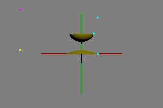

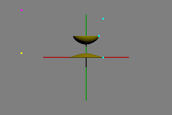

I spent some time on this idea and, on seeing some issues where entire
segments would just blink out of existence, I went back to trying more
parser legal point sets and found similar weirdness. :-(
There exists internal cylinder bounding of segments intended to reduce
the number of calls to the solvers. My guess is that code isn't
completely solid, but who knows.
Attached an image where the top row uses the currently legal point set of:
     <+1.5,-0.01> // C0
     <+0.4, 0.0>  // P1
     <+0.3, 0.5>  // P2
     <+0.4, 0.9>  // P3
     <+1.5,+0.91> // C4
and the shape breaks apart(a)(b). In the bottom row I changed that last
control point to:
    <+1.5,+0.901> // C4
and the entire top segment drops out.
So yep...
Bill P.
(a) Curve going negative can already happen without negative control
points.
(b) In yuqk the parts of the sor there all look good. In v3.8 beta 2,
the results for top segment are noisy; Likely solver differences.
Download 'sor_oddness.png' (22 KB)
