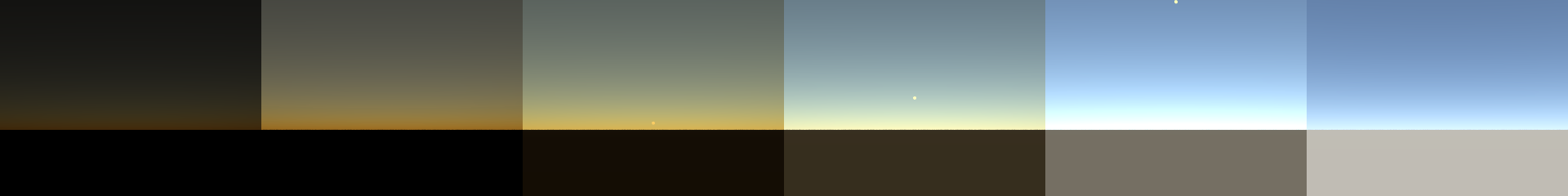

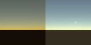

1) Elevation
parameters unchanged. We get FirstBlueSky_-5_-1-1_5_20_70_deg.png. Not so
bad, considering we only changed the elevation of the sun. The principle
seems to work. We do have the redenning of the light, and we get something
'acceptable' when the sun is below the horizon. Obviously, these are not
perfect colors, but I recall, this is what we obtain considering only pure
atmosphere, with only Rayleigh scattering, no other particles, no other
effect or property. Not so bad on my opinion.

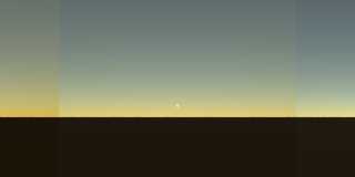

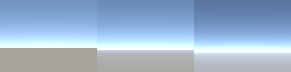

2) Altitude
pitch upwards. And we set altitude to different values: 2*m, 1000*m,
4000*m. We get FirstBlueSky_2_1000_4000_m.png. Visually and with a color
picker, we can see how the brightness decreases with altitude. This
behaviour was expected because at high altitude, the light encounters less
molecules (less distance + less density), there is less scattering, and we
see less blue and more black from the outer space (considered as 100%
black).

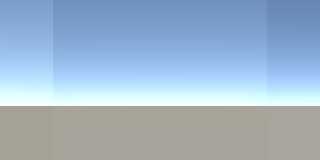

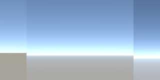

3) Density power factor
As seen previously, the density of the atmophere can be expressed by: d =
Dmax*exp(-k*h/T), where h is the atitude and T the thickness of the
atmosphere. In TerraPOV, the factor k os split into a default value
TP_BASE_RAYLEIGH_POWER that expresses 'normality'and valued to 6.7 for a
50km thick atmosphere, and a multiplying factor TP_RAYLEIGH_FACTOR,
defaulted to 1.
As we increase TP_RAYLEIGH_FACTOR, the density curve will sharpen and
become more spiky. The transition near the horizon will also be sharper.
The overall number of particles will also decrease and there will be less
scattering, yielding less reddening at low elevations. The sky will darken.
As we decrease TP_RAYLEIGH_FACTOR, the density curve will flatten. The
transition near the horizon will also be smoother. The overall number of
particles will also increase and there will be more scattering, yielding
more reddening at low elevations. The sky will lighten.

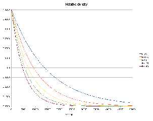

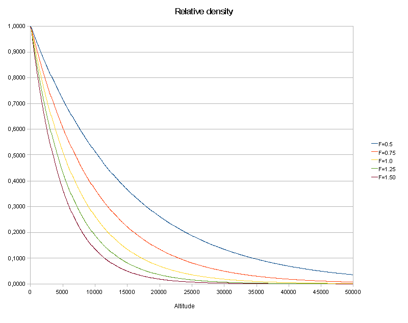

The picture RelativeDensity.png shows curves of relative density for
TP_RAYLEIGH_FACTOR = 0.5, 0.75, 1, 1.25, 1.5. The number of tarversed
particles is proportinal to the surface under the curve until considered
altitude.
REM: We can also control Dmax and compensate loss or gain of scattering,
but it's another aspect. And it sems we do not - at first - need to change
it.
FirstBlusSky_rayleigh_factor_0.5_0.75_1_1.25_1.5_elev45.png.
FirstBlusSky_rayleigh_factor_0.5_0.75_1_1.25_1.5_elev2.png.
