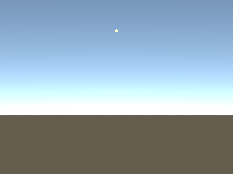

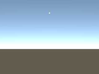

6) Render
We just add this statement
object {_tp_rayleigh_atmosphere}
and run ...
Yessssss!!!!
We get the attached image. It is the result without any tuning and
refinement for a PURE atmosphere, made only of air molecules, and taking
into account only the Rayleigh scattering effect, without anything else.
The true atmosphere is more complex. We have still a long way to go before
we can say that we are arrived to a good model. But even though this model
in still basic, it is quite satisfactory.

     sphere {0, TP_EARTH_RADIUS + TP_ATMO_BOTTOM + TP_ATMO_THICKNESS
translate -TP_EARTH_RADIUS*y}
     sphere {0, TP_EARTH_RADIUS + TP_ATMO_BOTTOM translate
-TP_EARTH_RADIUS*y}
     hollow
     pigment {rgbt 1}
     interior {media{_tp_rayleigh_media}}
// Default camera
#declare _tp_default_camera = camera
     location 0
     angle TP_DEFCAM_ANGLE
     right     x*image_width/image_height
     look_at   z
     rotate -TP_DEFCAM_ELEVATION*x
     rotate TP_DEFCAM_HEADING*y
     translate TP_DEFCAM_HEIGHT*y // Could use trace() to make sure we are
above the surface. But no terrain yet ...
// Scene
object {_tp_earth}
object {_tp_basic_sun}
camera {_tp_default_camera}
http://www.opera.com/mail/
Download 'firstbluesky.png' (14 KB)
Preview of image 'firstbluesky.png'
From: SharkD
Subject: Re: TerraPOV - Sky system - Atmosphere - Part3, A Blue Sky
Date: 2 Sep 2009 09:25:01
Message: <web.4a9e715cf101452efda47a750@news.povray.org>
A couple of comments:
1. The sky seems very gray to me, almost metallic.
2. If you use a spherical camera you'll notice that there are two bright spots
in the sky positioned 180 degrees from one another.
-Mike
From: SharkD
Date: 2 Sep 2009 09:38:03
Message: <4a9e753b@news.povray.org>
> -Mike
Nevermind. This seems to be addressed in the later parts of the tutorial.
-Mike
