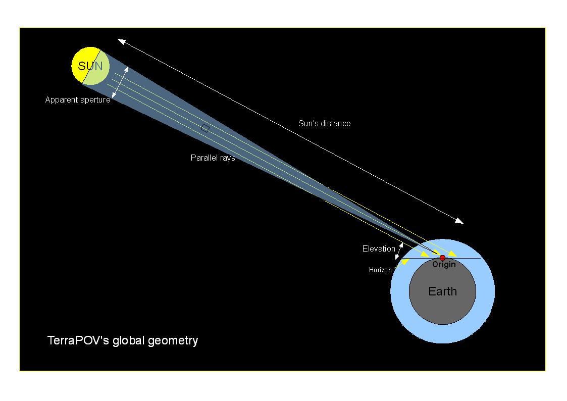

This article explains TerraPOV's global geometric model for a scene. This
involves Earth's and Sun's geometric parameters.
Just before we begin, we have to define some distance units we will often
use in TerraPOV:
#declare m = 0.1; // A value of 1 makes the sun's distance ouside POV's
numerical domain.
#declare km = 1000*m;
#declare mm = 0.001*m;
And, like POV-SDL, TerraPOV uses degrees for angles.

2) Sun
The sun is the main light source for TerraPOV scenes. The sun's apparent
aperture, due to real distance, allows to assume that the rays are
parallel. At first, we use a simple parallel white light_source that
looks_like a shere. The necessity to have a more advanced model for the
sun depends on the type of sky used in the scene, whether clouds are
present and if the sun is totally/partially hidden behind, its elevation.
Until now I could not find a general model of the sun that can fit a few
frequent situations. I'll come back to it later. The color of the
light_source is expressed through 2 values: a color and a brightness,
multiplied together. Later, the color could be normalized in order to
match the energy of white (white carries an energy The brightness is used
to compensate lightness diminution when the sun is hidden behind clouds or
at low elevations.

3) Camera
We use a standard persepective camera, and the main parametes are
contallable. In a normal lanscape scene, we can drop the camera above the
terrain, helped by a preview image, and rough and fine offsets can be be
applied. The camera can also be placed with respect to an object. For now,
we just position the camera above the ground, at humain height. Let's also
imagine that TerraPOV can provide several cameras, for different pusposes.

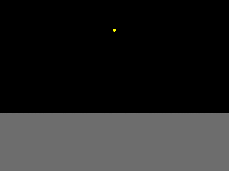

Now we have someting that expresses the global geometry of a TerraPOV
scene. However it's still very basic, but we have already separated
interesting parameters from the 'engine'.
// Scene
object {_tp_earth}
object {_tp_basic_sun}
camera {_tp_default_camera}
We put all together and render the scene. One can play with parameters.

Ok folks, I have finished for this part. Next article will add an
atmosphere, and we'll get a blue sky ... automatically....
Coming next: TerraPOV - Sky system - Atmosphere - Part3, A Blue Sky
