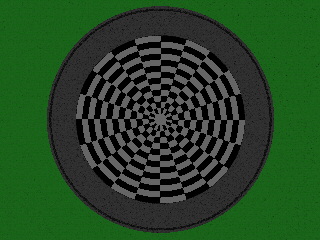

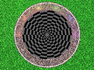

Hi everyone!  I've been working on a scene and I'm having some trouble with
some cylindrical lights I have in there.  In a nutshell, the scene thus far
is a top view of a floor (made of nested discs), surrounded by a moat-like
stone ring.  The bottom of the ring is at -3 along the y axis.  I have 6
cylinder lights all starting at <0, 0, 82> and rotated to the places I want
them.  The problem is that they don't light anything unless I make them
shadowless.  I'm including 2 images... the first one rendered without the
shadowless lights, the second with them.  I'm guessing that they're not
lighting anything because there's something blocking them and casting a
shadow.  I tried using the "no_shadow" option on the objects around the
lights, but it didn't help.  What's wrong?  I'm also attaching the source.
I'd appreciate any help anyone could give me.
Thanks!
Dave.

Try changing all your point_at 50*y to -50*y to direct them downward
instead. They still behave like spotlights, that is, they point in one
direction; not endless cylinders going in both directions. I first
thought they did myself.
I didn't try your script out, though I believe that is the answer.

Actually I want them to point up... in the original version of this scene
there are more objects that they should be shining on.  When I realized they
weren't shining on anything, I began commenting out things one by one to try
to find out what was blocking the lights.  I copied the "un-commented" code
into a new file to post.  Otherwise I'd have sent in a .pov file with
something like 500 lines commented out -- more than half.  I will try your
suggestion though, and see if it makes any difference.  If it does, then at
least it'll be a starting point.

>> // effect.  Kind of like the floor on the stage of this year's Academy
Awards, but not exactly.
>> #declare rad =
>> pigment {
>>         radial
>>         color_map {
>>                 [0.5 color rgb 1.0]
>>                 [0.5 color rgb 0.0]
>>         frequency 10
>> // here is the texture of the rings that will surround the floor
>> // and contain the fountains, and for all the other stone in the scene as
well.
>> #declare stonetexture =
>> texture {
>>         pigment {
>>                 color rgb 0.5
>>         normal {granite 1}
>> // Lights... camera... ...ray trace!
>> light_source {
>>         <0, 1000, 0>
>>         color rgb 0.5//<0.17, 0.17, 0.2>
>>         media_attenuation off
>>         media_interaction off
>>         shadowless // this is always shadowless.  just to help illuminate
things while I try
>>                    // to figure out why the cylinder lights don't light
>> // these are the cylindrical lights
>> light_source { // #1
>>         <0, 0, 82>
>>         color rgb <2.00, 0.50, 0.50>
>>         cylinder
>>         radius 45
>>         falloff 47
>>         tightness 100
>>         point_at <0, 50, 82>
>>         rotate <0, 270, 0>
>>         media_interaction on
>>         shadowless //made this shadowless for test run
>> light_source { //#2
>>         <0, 0, 82>
>>         color rgb <2.00, 1.00, 0.50>
>>         cylinder
>>         radius 45
>>         falloff 47
>>         tightness 100
>>         rotate <0, 306, 0>
>> light_source { //#3
>>         <0, 0, 82>
>>         color rgb <2.00, 2.00, 0.50>
>>         cylinder
>>         radius 45
>>         falloff 47
>>         tightness 100
>>         rotate <0, 342, 0>
>> light_source { //#4
>>         <0, 0, 82>
>>         color rgb <0.50, 2.00, 0.50>
>>         cylinder
>>         radius 45
>>         falloff 60
>>         tightness 100
>>         rotate <0, 18, 0>
>> light_source { //#5
>>         <0, 0, 82>
>>         color rgb <0.50, 0.50, 2.00>
>>         cylinder
>>         radius 45
>>         falloff 47
>>         tightness 100
>>         rotate <0, 54, 0>
>> light_source { //#6
>>         <0, 0, 82>
>>         color rgb <2.00, 0.50, 2.00>
>>         cylinder
>>         radius 45
>>         falloff 47
>>         tightness 100
>>         rotate <0, 90, 0>
>> camera {
>>         location <0, 200, 0>
>>         look_at <0, 0, 0>
>> // Every scene needs some objects.
>> // I've never used discs before.. but layering concentric rings
>> // was the only way I could think of to get the pattern I wanted.
>> // The discs have the "rad" pattern, one half phase off from each other.
>> disc { // White circle in the center
>>         <0, 0, 0>, y, 5
>>         pigment {color rgb 1}
>> disc {
>>         <0, 0, 0>, y, 10, 5
>>         pigment {rad}
>> disc {
>>         <0, 0, 0>, y, 15, 10
>>         pigment {rad phase 0.5}
>> disc {
>>         <0, 0, 0>, y, 20, 15
>>         pigment {rad}
>> disc {
>>         <0, 0, 0>, y, 25, 20
>> disc {
>>         <0, 0, 0>, y, 30, 25
>>         pigment {rad}
>> disc {
>>         <0, 0, 0>, y, 35, 30
>> disc {
>>         <0, 0, 0>, y, 40, 35
>>         pigment {rad}
>> disc {
>>         <0, 0, 0>, y, 45, 40
>> disc {
>>         <0, 0, 0>, y, 50, 45
>>         pigment {rad}
>> disc {
>>         <0, 0, 0>, y, 55, 50
>> disc {
>>         <0, 0, 0>, y, 60, 55
>>         pigment {rad}
>> disc {
>>         <0, 0, 0>, y, 65, 60
>> disc {
>>         <0, 0, 0>, y, 70, 65
>>         pigment {rad}
>> // this large ring immediately surrounds the floor
>> difference {
>>         cylinder {
>>                 <0, -3, 0>, <0, 1, 0>, 72
>>         cylinder {
>>                 <0, -3.1, 0>, <0, 1.1, 0>, 70
>>         texture {stonetexture}
>> // this outer ring will surround the floor, and the several mini-rings
that will hold the fountains.
>> difference {
>>         cylinder {
>>                 <0, -3, 0>, <0, 1, 0>, 94
>>         cylinder {
>>                 <0, -3.1, 0>, <0, 1.1, 0>, 92
>> // Here's the ground that will surround the floor.  I cut out the area
where
>> // the floor and rings are so you don't see grass (or this really bad
>> // aproximation of grass) in the bottom.
>> difference {
>>         plane {
>>                 y, -0.5
>>                 texture {
>>                         pigment {
>>                                 color rgb <0.25, 1.00, 0.25>
>>                         normal {
>>                                 average
>>                                 normal_map {         // just arbitary
trial & error numbers to not
>>                                         [granite 2]  // have too smooth
of a ground
>>                                         [bumps 1]
>>                                         [dents 2]
>>                                         [crackle 1]
>>                 hollow
>>         cylinder {
>>                 <0, -3.00001, 0>, <0, 1, 0>, 94
>>                 texture {
>>                         pigment {
>>                                 color rgb 0.50
>>                         normal {
>>                                 average
>>                                 normal_map {
>>                                         [granite 2]  // more arbitrary
trial & error valuse to make
>>                                         [crackle 2]  // the inside of the
pools not be smooth
>>          hollow
>>          no_shadow
>>         hollow on
> omniVERSE: beyond the universe
