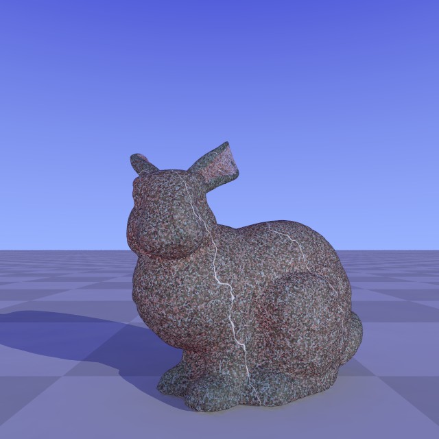

From: Bald Eagle
Subject: Re: Dakota Red Granite macro - beta #1.2
Date: 24 May 2021 06:25:00
Message: <web.60ab7e4cc1167ed21f9dae3025979125@news.povray.org>
> Right. I was sure I would get this comment! ;-)
> I was lazy of course and pushed it forwards.
Sometimes it's best to just push it back out into the wild.
> > But maybe to alert the user to the fact that they may have inadvertently left
> > out a parameter or used a misspelling/typo, issue a warning in the #ifndef
> > block.
> Hmm... yes, that might be smart. I need to think about this a bit.
> The following, I want to comment on separately. Needs more thoughts.
> In the meantime, I am also working on a working sslt set... Not so easy!
> For instance, a layered texture (veins!) makes sslt go bad.
I went looking for sslt scene code, and that rotating pyramid again...
and got sidetracked.
Here's some granite with HDR lighting and radiosity.
I noticed that I probably didn't scale the texture properly, and so I can't
really see any of the veins.  In my readings, clipka mentioned that having the
mm_per_unit setting was there to decouple the texture from POV-units and so be
independent of scaling effects.  We might want to do similar with a
default-if-not-supplied, and a debug/warning message saying what it got set to.
I think that sometimes it is a bit slow to render - depending on how the scene
is set up.   Maybe have some quick-color definitions set up.  For ridiculously
high quality, I'm guessing we'd want some switchable reflection built in as well
for the same not0 reasons.
Download 'dakotaredradiosity.png' (3990 KB)
Date: 24 May 2021 07:31:27
Message: <60ab8e8f$1@news.povray.org>
Op 24-5-2021 om 12:22 schreef Bald Eagle:
Looking good and interesting.
Something I noticed with sslt in my settings, is that veins seem to
become really 'thin' or, more probably, 'transparent', and thus tend to
/disappear/ from the view except with higher magnification.
There are still a lot of issues with the technique (the layered textures
I mentioned for instance) which are not (fully) addressed in the
documentation as-is. Not for nothing that the technique is still
experimental. However, we may get at something workable if not
breath-taking ;-) on the way.
The mm_per_unit setting is essential and its default (10) seems at first
glance to be ok for the granite. I am trying to get a grip on how to
tweak the translucency parameter. For instance, I experimented with the
use of a complementary colour instead of a regular colour taken from the
granite colour_map, with interesting results. Visual examples later on.
Yes, and yes, and yes.

/lower/ layer and *not* in the top layer. Just comment it out there.
(2) Scaling of the granite material is related to the /original/ size of
the object. In my system, I scale the bunny 10x /before/ applying the
granite material. Consequently, I use the optional M_scale = 0.10; or
close to that value in the macro.
Date: 24 May 2021 11:33:52
Message: <60abc760@news.povray.org>
Op 24-5-2021 om 15:01 schreef Thomas de Groot:
> For your consideration, concerning sslt:
> (1) It looks like that when using the layered texture mode, i.e. with
> veins through the granite, sslt should *only* be switched on in the
See attached image. Translucency has been a bit exagerated:
  <0.669, 0.229, 0.198>*5;
In fact this has nothing to do with sslt;-)
Download 'dakotared_sslt_test1.jpg' (59 KB)
Preview of image 'dakotared_sslt_test1.jpg'
From: Bald Eagle
Yes, I think some of that happened in the early experiments with people applying
sslt to objects.  Some details nearly disappeared.
There should definitely be a parameter passed to the macro for width of the
vein, and frequency of occurrence.
Now that it's looking good, I'd say it's time to think about how to pass
alternative color maps into the texture - both to model other granite types, as
well as use the change to spot something in the current implementation that
might be hiding, but a different color scheme might bring out.
Piggybacking on that idea, there should be some triggerable material attribute
data output to #debug with numbered map entries, and then we could have a
mechanism to pass in a color for a single entry on-the-fly.  Then it would be
easy to plug the macro calls into a loop and render a ton of different samples
when tweaking a new material.
The macro should also top up my coffee or G&T while I'm working on a scene,
depending on the value of a required parameter.  :D
The way clipka explained it that the translucency color is geared toward what
color you want the sslt effect to take on as it percolates through the material.
 So for skin, where the blood will add a red color and absorb the blue and
green, you set the color to a red-channel dominant rgb vector.
Maybe the best sslt test-bed would be a back-lit wedge of material, much like
what Ansel Adams would do with the Zone System when calibrating negatives and
prints.
Clipka also recommended in one thread to overlay the sslt texture layer with
something else and maybe(?) he specifically said to only set the sslt in the
lower layer...  I'd have to search and pull it up.
Have to head out and do some errands, so won't be back until later in case you
can't find it with a quick "sslt" search.
- Bill
> prints.
This is a thin prism (0 to 0.1) with a single point light behind the left edge.
I'm wondering if eval_pigment could act as a way to guide the result?
Download 'granitessltwedge.png' (91 KB)
Preview of image 'granitessltwedge.png'
> prints.
Yes. I used the bunny...
That is definitely what one should do as far as my tests show.
