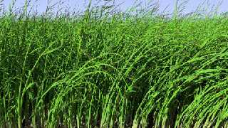

From: LanuHum
Subject: Re: Wind pattern code and reed stalk example
Date: 19 Sep 2014 15:55:01
Message: <web.541c89c0825f35c27a3e03fe0@news.povray.org>
> Attached is my code. You have all latitude to make changes, experiment,
> or expand.
> Enjoy!
> Thomas
In the console there are a lot of lines:
File '/usr/share/povray-3.7/include/math.inc' line 232: Possible Parse Error:
Normalizing zero-length vector.
But, the render started.
Interesting work! :)
Download 'wind_pattern.jpg' (86 KB)
Preview of image 'wind_pattern.jpg'

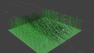

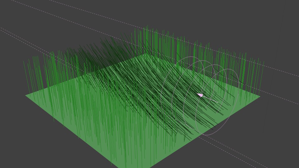

Thomas,thanks.
I started understanding your mechanism.
But, I had an idea to use means of Blender (force field : wind) to do without
excess mathematical calculations.
Wind is applied to particles, but there is no realistic bend
It is necessary to find only the solution of a realistic bend of a trunk of a
plant also means of Blender
Download 'force_field_wind.jpg' (99 KB)
Preview of image 'force_field_wind.jpg'
