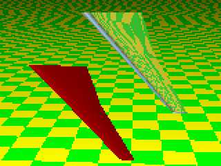

This is the scene-file that demonstrates the problem with shiny bicubic
patches.
In the povray.binaries.images I have uploaded some graphics that show you
the location of the control points, to "prove" that the edges connect and
line-up smoothly.
This message belongs to "Re: Possible bug in shiny bicubic_patch (82kb)" in
povray.binaries.images and "Re: Possible bug in shiny bicubic_patch" in
povray.general
Download 'object_view.zip' (3 KB) Download 'object_view.png' (10 KB)
