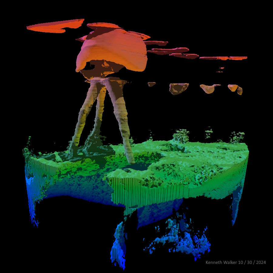

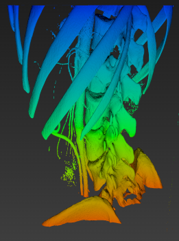

2. How it will work for isosurface approach (see attached
image):  https://povlab.online/?scene=dicom_iso.pov
I am continuing to think about a volume rendering service with Three.js
based GUI with POV on the server side and your method can simplify
implementation if we will not see quality degradation. In general DICOM
is a great source of data for volumes, thanks for displaying your
teeths, hope you will not need this operation in future.
YB
Download 'dicom_iso.png' (97 KB)
Preview of image 'dicom_iso.png'
From: Kenneth
Subject: Re: multiple image_maps as media density-- 'fake' .df3
Date: 27 Oct 2024 12:05:00
Message: <web.671e61fb7fd6ccd91c33a706e066e29@news.povray.org>
yesbird <sya### [at] gmailcom> wrote:
> color gradient on your images is not very smooth, compared to
> traditional method, but maybe this is colormap dependent.
Your media images from your earlier post definitely look much nicer than mine.
The main problem I am having is that the original DICOM images from my own CT
scan are *extremely* noisy and of low quality; it is even difficult to see what
is 'organic matter' and what is just noise. And the exposure level from image to
image seems to change at random, which I suspect is a result of the CT's x-rays
being 'auto-compensated' for changes in bone density (or whatever!)
The color_map I used (and the altered gamma setting for the images) was the
result of a lot of experimentation, to see if I could suppress some of the noisy
'garbage' and still retain some of the important details and structures. Small
tweaks to the color_map produce large changes in the visual appearance!
I have attached a sample of my original DICOM images (as converted to
8-bit .png) just to show what the problems are. I think that the images you are
using are of *much* higher quality.
In my opinion, my dentist needs to purchase an improved CT scanner! ;-)
> 2. How it will work for isosurface approach?
I am working on that at the moment (thanks for the suggestion!) I will post the
result when finished.
Here is the isosurface example, using the same series of images. It worked,
although I had difficulty with the noise in the original images.
The PIG_SLICES function code is the same as before, but instead of using it for
media, I used...
isosurface {
  function {1.19 - PIG_SLICES(x,y,z).red}
  contained_by {box {.001, .999}}
  threshold .65
  accuracy .0001
  max_gradient 390
texture{...}
I chose the various values-- especially the 1.19-- to try and eliminate as much
of the noise as possible...without wiping out *too* much of the detail. Then I
rotated the isosurface into a more visually interesting orientation.
Surprisingly, it does not show a 'stair-step' appearance from the individual
image_maps; they are all nicely blended together.
Thanks yesbird for the inspiration! While working on this, I discovered
something important (and off-topic) that has given me big problems in the past,
concerning the fact that this isosurface actually responds to *lighting*. I was
not expecting that. The reason why is worth a separate post, if I can get around
to it. ;-)
Download 'image_stack_as_isosurface_1_kw.jpg' (102 KB)
Preview of image 'image_stack_as_isosurface_1_kw.jpg'
Yes, I know - sometimes even in real life it is very difficult to
separate useful info from noise :).
Really interesting and unexpected - in general even with such low
resolution image looks smoothly. The noisy sources sometimes produces
very impressive effects - in this particular case it reminds me old VHS
fantastic movies, something like "Spiders from Mars" or "War of the
Worlds" (see attached image with post-production effect :)).
> to it. ;-)
Looking forward to look at your future investigations.
YB
