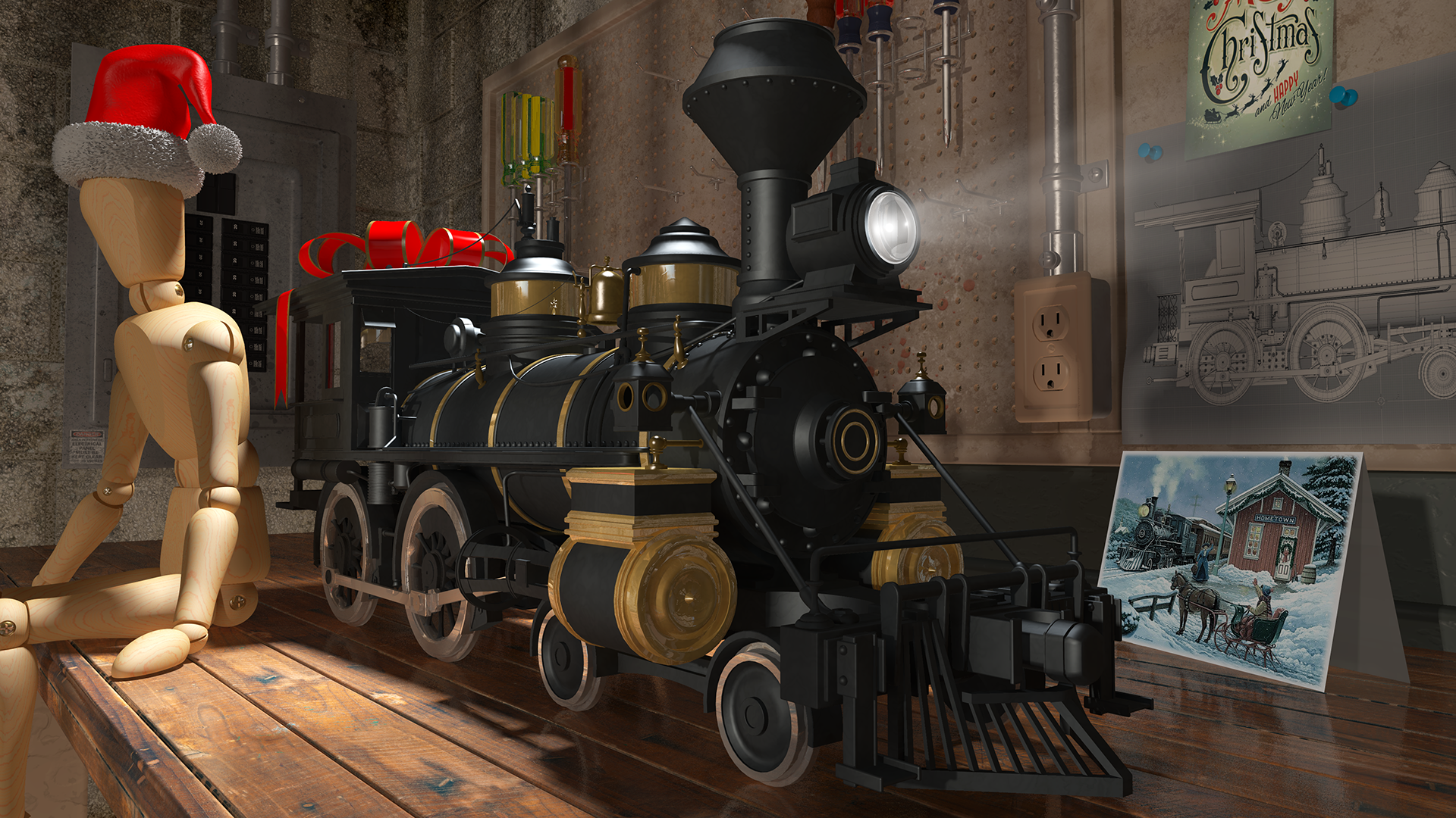

Updated train on workbench. Added Santa hat on mannequin, ribbon/bow on train,
and a few Christmas cards. Getting close on this one. May tweak the view angle a
bit.
Miller.

The textures of the metal trimmings on the locomotive look milky.  I suggest
lowering the diffuse and ambient values in the finish.
Thanks...I'll take a look at that.

Thanks for the info. The metal finishes I used have been tweaked from files long
ago. :) I'll review what I'm using and test out your suggestions. I'm sure I've
not tried adding a clear coat to basic metals.

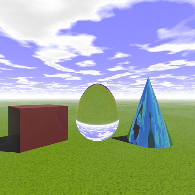

I probably made a mistake somewhere, but I have a problem with this. The
object looses its shadow in my code (see the egg in attached image).
This is the code used for the egg finish:
ovus { 1.00, 0.65
   pigment {rgb <0.4, 0.9, 0.4>}
   pigment {rgbt <0.9, 0.1, 0.1, 0.99>} //varnish coating!
   finish {
     metallic
     diffuse 0.0
     specular 0.80
     roughness 1/20
     reflection {0.90 fresnel metallic}
   interior {ior 1.5}
   scale 0.5
   translate <0, 0.5, 0>
} // end of ovus --------------------------------------
specular / roughness can be left out without visible changes btw.
Thanks for any light on this!

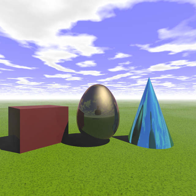

Op 7-12-2023 om 09:37 schreef Thomas de Groot:
Not entirely true. Better leave those in place for the varnish (see image)

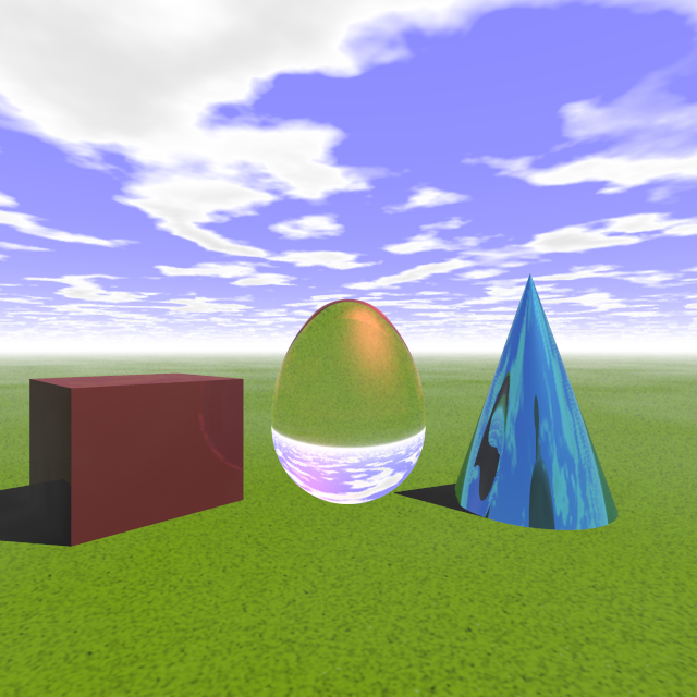

Try it this way:
ovus { 1.00, 0.65
   texture {
      finish {
         metallic
         diffuse 0.0
         ambient 0.0
         specular 0.80
         roughness 1/20
         reflection {0.90 metallic}
   texture {
      finish {
         reflection {0.90 fresnel}
   interior {ior 1.5}
   scale 0.5

Op 7-12-2023 om 14:19 schreef Cousin Ricky:
> Try it this way:
> ovus { 1.00, 0.65
>     texture {
>        finish {
>           metallic
>           diffuse 0.0
>           ambient 0.0
>           specular 0.80
>           roughness 1/20
>     texture {
>        finish {
>     interior {ior 1.5}
>     scale 0.5
Aaa...! Of course. Thanks so much!
The coating is improved with specular, roughness and metallic added.

shorthand update trick, ignores any defined interior_texture{} without a
peep.
Well, on digging into the code recently with the idea of fixing that
long-standing oversight in yuqk, I found there are additional criteria
related to the type of pattern / special patterns in play too as to
whether the short hand texture aspect updates work - even for texture{}.
So... I'm now toying with the idea of making all shorthand updates,
parse errors in yuqk and suggesting this for v4.0 too. Essentially, yuqk
would be forcing the texture{} block specification(s), always, as a path
to consistent overall behavior.
This idea is easier for me to swallow because I tend to assign finish{},
normal{}, pigment{} (and interior{}) blocks to IDs before using them in
texture{} or material{} blocks - also assigned to IDs - prior to use
with objects. In other words, I already often code in this style. I do
it because it makes modifications easier - but, it also avoids some of
the subtle shifts / inconsistencies in parsing behavior which happen
today with the texture shorthand / aspect update methods.
Aside: As an additional plus, forcing texture{} block(s) would enable
eventual simplifications in the parsing code. This, rather than
extending already complicated code to support interior_texture{}
shorthand / aspect updates.
Thoughts / comments?
