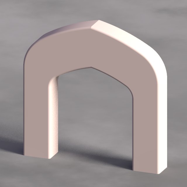

Hi,
A four-centered arch. Macro coming up shortly.
Sam

Here it is. The outer and inner arches are defined separately by width, height
and corner radius (smallest circle). Everything else applies to the entire
object.
#macro FourCenteredArch
  AW1, // arch width 1 (from center)
  AH1, // arch height 1 (from ground)
  CR1, // radius 1 (outer corner, >=0 & <=AW1)
  AW2, // arch width 2 (from center)
  AH2, // arch height 2 (from ground)
  CR2, // radius 2 (inner corner, >=0 & <=AW2)
  AD, // arch depth (to -z)
  BV, // edge bevel radius
 // a small value
 #local Eps = .0001;
 // intersection of a vertical line and circle, produces a y value (circle
radius, line x-position)
 #macro CircleLineIntercept(CirR, LinX)
  #local V = pow(CirR, 2) - pow(LinX, 2);
  #if(V>=0)
   (sqrt(V))
  #else
   (0)
  #end
 #end
 // calculate and return various values for shape and bevel macros
 #macro GetValues(AW, AH, CR, IO) // IO = is outside inside shape
  #declare CR = max(CR, BV*IO+Eps); // prevent circle radius from being negative
  #if(CR>=AW) #declare CR = AW-Eps; #end // prevent degenerate plane normal
  #declare CV  = <AW-CR, AH, 0>; // small circle position
  #declare CRT = 2 * CV.x; // get a temporarory circle radius based on distance
between initial circle centers
  #declare CY = (CircleLineIntercept(CRT, CV.x)); // get intercept of line and
1st circle
  #declare CV2 = CV - 2 * <CV.x, CY, 0>; // large  circle's position (will be
used directly for geometry)
  #declare CRL = 2 * CRT + CR; // large (second) circle's radius
  #declare CY2 = (CircleLineIntercept(CRL, CV2.x)); // value needed for shifting
geometry down (get y intercept of line and 2nd circle)
  #declare CO = (CV2.y+CY2-AH); // offset amount to shift geometry downward, to
fit inside box and top margin
  #declare CV = <CV.x, CV.y-CO, 0>; // offset CV
  #declare CV2 = <CV2.x, CV2.y-CO, 0>; // offset CV2
  #declare Dir = vnormalize(CV - CV2); // angle between 1st and 2nd circle
centers, used for various things
  #declare DirP = <Dir.y, -Dir.x, 0>; // perpendicular to Dir
  #declare ISP = <CV2.x-(CV2.y-CV.y)*Dir.x/Dir.y, CV.y, 0>; // find an
intersection to be used to prevent future CSG issues
  #declare PlaneDirP = plane{<CV2.y-CV.y, -CV2.x+CV.x, 0>, 0 translate CV}
 #end
 // basic shape
 #macro MakeShape(AW, AH, CR, AD, IC, IO)
  #local IC = Eps * IC; // is a cutting object, so make an offset
  union{
   // solid portion under curve
   box{<-IC, -IC, 0-IC>, <AW, CV.y+Eps, AD+IC>}
   #macro Curve()
    union{
     difference{
      cylinder{
       z*(-IC), z*(AD+IC), CR
       translate CV
      plane{y, CV.y-Eps}
      object{PlaneDirP inverse}
     difference{
      cylinder{
       z*(-IC), z*(AD+IC), CRL
       translate CV2
      plane{x, -IC}
      object{PlaneDirP translate -y*IC}
   #end
   object{Curve()}
   translate -z*AD
 #end
 // bevels for curved portion
 #macro MakeBevel(AW, AH, CR, IO)
  union{
   difference{
    torus{
     CR, BV
     rotate x*90
     translate CV+z*(BV-AD)
    plane{y, CV.y}
   difference{
    torus{
     CRL, BV
     rotate x*90
     translate CV2+z*(BV-AD)
    plane{x, 0}
    object{PlaneDirP}
 #end
 // final object
 union{
  #local ArchHalf =
   union{
    // shape offset +z by bevel value
    difference{
     MakeShape(AW1, AH1, CR1, AD-BV, false, true)
     MakeShape(AW2, AH2, CR2, AD-BV, true, false)
    // shape inset by bevel value
    #if(BV>0)
     difference{
      MakeShape(AW1-BV, AH1-BV, CR1-BV, AD, false, true)
      MakeShape(AW2+BV, AH2+BV, CR2+BV, AD, true, false)
     // bevels
     union{
      object{MakeBevel(AW1-BV, AH1-BV, CR1-BV, true)}
      cylinder{<AW1-BV, 0, -AD+BV>, <AW1-BV, CV.y, -AD+BV>, BV}
      object{MakeBevel(AW2+BV, AH2+BV, CR2+BV, false)}
      cylinder{<AW2+BV, 0, -AD+BV>, <AW2+BV, CV.y, -AD+BV>, BV}
    #end
  object{ArchHalf}
  object{ArchHalf scale <-1, 1, 1>}
#end
Here's how to call the macro:
object{
 FourCenteredArch(
  1.0, // arch width 1 (from center)
  2.0, // arch height 1 (from ground)
  0.5, // radius 1 (outer corner, >=0 & <=arch width 1)
  0.6, // arch width 2 (from center)
  1.4, // arch height 2 (from ground)
  0.2, // radius 2 (inner corner, >=0 & <=arch width 2)
  0.3, // arch depth (to -z)
  0.03 // edge bevel radius (>arch depth)

Nice job!

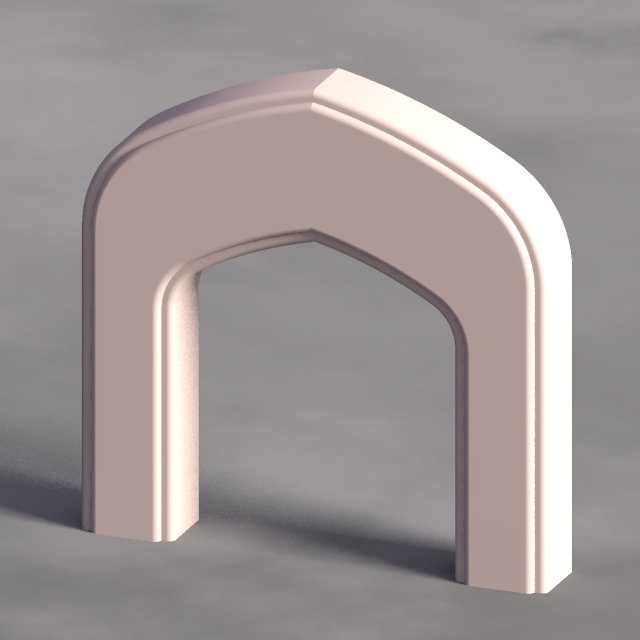

Here's a helper macro to make arches with inset surfaces. You can specify both
inset amount and inset depth.
#macro FourCenteredArch_Inset(AW1, AH1, CR1,  AW2, AH2, CR2,  AD, BV, IN, ID)
 #local Eps = .0001;
 union{
  FourCenteredArch(AW1, AH1, CR1,  AW2, AH2, CR2,  AD-ID, BV)
  object{
   #local DP =  max(BV+Eps, ID);
   FourCenteredArch(AW1-IN, AH1-IN, CR1-IN,  AW2+IN, AH2+IN, CR2+IN, DP, BV)
   translate - z*(AD-DP)
#end
And its usage:
object{
     0.3, // radius 1 (outer corner, >=0 & <=arch width 1)
     1.35, // arch height 2 (from ground)
     0.1, // radius 2 (inner corner, >=0 & <=arch width 2)
     0.013, // edge bevel radius (>arch depth)
     0.05 // inset amount
     0.025 // inset depth

Looks beautiful.
