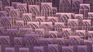

Hi,
Here's a piece of gothitecture I cooked up the last couple of days. It's a
generic gothic/medieval window macro. Nothing too involved. The glass beveling
is a simple surface normal, and everything else is just good old, traditional
CSG.
Macro incoming...
Sam
Download 'gothicarchb6m_43s.jpg' (348 KB)
Preview of image 'gothicarchb6m_43s.jpg'

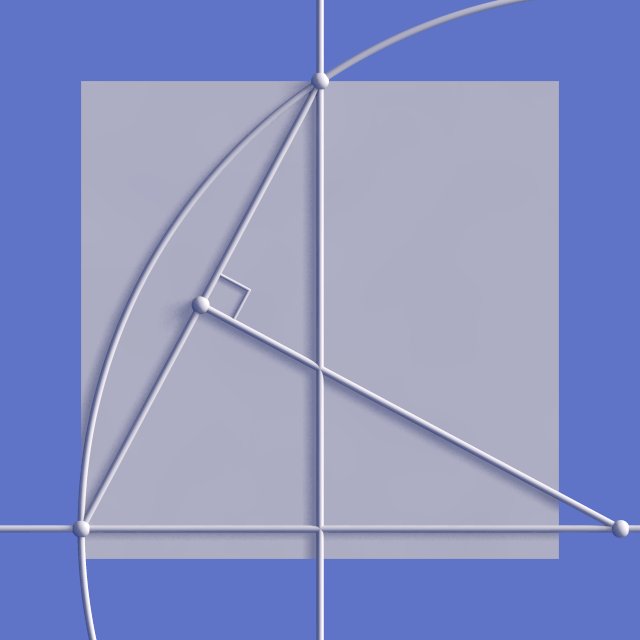

From: Samuel B
Subject: Re: Gothic cathedral window generator
Date: 17 Jul 2023 20:45:00
Message: <web.64b5e03d37209b7ff8c47d526e741498@news.povray.org>
And here's an image showcasing the underlying geometry behind all this.
Basically: for any given window width and arch height, find an appropriate
circle to describe the arch.
Download 'gothicarchgeom.jpg' (22 KB)
Preview of image 'gothicarchgeom.jpg'

From: Bald Eagle
Date: 18 Jul 2023 00:20:00
Message: <web.64b6129537209b7f1f9dae3025979125@news.povray.org>
I've wound up deriving that solution from scratch about a dozen times     :D
Nice macro.
- BW

Aaah! I love this! Can it do the typically English 4-centered arch? I
have been trying to write a macro lately but did not get very far.
> Nice macro.
> - BW
Isn't that just the way? So many times I've worked on a problem only to discover
that I had already solved it before, yet I somehow forgot! I think this was the
first time I figured out this particular problem, and the solution had me
stymied for a bit too long... but I had fun the whole time ^_^
Btw, what were you using this kind of geometry for?
Sam

Thanks, Thomas!
Just looked up the 4-centered arch, and no, it cannot make those. This macro
only produces arches with single circular segments, while the 4-centered arch
seems to require at least two. Or worse, it uses some sort of curve not composed
entirely of circles. I'll look further into it though, and possibly make a
separate macro.
I've love to make a single all-purpose macro to cover everything, but there
seems to be as many window/arch variations as there are stars in the sky. (Ok,
that's a bit hyperbolic, but with all the extra details architects used, there
are a lot of designs out there.)
Sam
