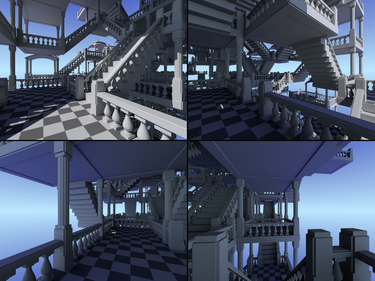

Here's a few images from within the structure.
I added a randomized camera to put the viewer on a random floor, and spent some
time detailing the various components so it stands up to closer scrutiny. This
also revealed a whole slew of placement bugs that didn't really show up on the
distant view. The rails, posts and corner posts are now predeclared meshes, so
parsing time has gone down and the memory footprint should be smaller.
There's still some things I want to improve - there are some big gaps at the end
of the railings in some cases, I'd like to add some textures, and possibly a
couple more objects (e.g. planters). If I can maintain the momentum, I'll also
play with the environment and placement structure a bit...
Bill

Hi Bill,
That's looking great :-) Thank you for sharing !
All the views seem to be on the 'surface' of the structure. I don't know what
your lighting setup is but I presume there is only one light_source outside the
structure. Is it getting too dark as you move deeper inside it ? In that case, I
wonder how it would look like if there was no light outside and light inside
some of rooms instead...
Hope you'll maintain momentum !
Pascal

Bill, that's looking very cool! So much work.
So much there already that, yes, a touch of algorithmically generated planters
(and a big measure of patience) would fill it in nicely. Nothing like 100+ hours
of work hanging on your wall.

Terribly good indeed!
Maybe something to look into: the stair steps. Taking into consideration
the size of the visitors to this structure, either the banisters are too
low, or the steps are to high. I guesstimate by a factor of two maybe a
bit more. This becomes only obvious in the close up views of course.
 From a distance, I am afraid the steps structure would become invisible
if reduced in height size.

This is - ridiculously good!
I'm of course curious about the method/rules you're using to assemble all the
parts, and how many lines of code you're up to now!  ;)
Yup, the interesting views all ended up being on the outside, somewhere in the
middle. Although the ones right on top are cool too!
> I don't know what
> the structure. Is it getting too dark as you move deeper inside it ? In that
> case, I wonder how it would look like if there was no light outside and light
> inside some of rooms instead...
Yup, a single sun, then the ambient light cast by the lit areas and the
surrounding sky. And yes, it does get quite dark in the middle, although that's
not why I didn't include any 'inner' views - I just found the edge views to be
nicer from a visual composition perspective :)
It had occurred to me to put a central sun with a darker environment, but I
haven't tried it yet. Adding lights as one of the cell building components is a
good idea, but a large number of conventional lights in a scene like this would
likely be a slow render. However, I'm using UberPOV for this, so a better
approach might be to use radiosity-only lights and crank up the count...
Bill
> bit more.
Yeah you're right! I'd like to address this - I'll have to tweak the post size
too because they're almost as wide as the steps. I'm a little limited, because
the stairs need to remain at 45 degrees for ease of assembly, but it should be
possible to improve the scale at least.
There's another improvement I'd like to make - if you look carefully at a
staircase edge-on, you'll notice that the steps start at floor level at the
bottom, but end below floor level at the top. This means that the staircase
doesn't currently bisect a cell, they're very slighty less than 45 degrees. If I
ever want to make longer staircases that span many cells, I'll need to change
the arrangement slightly so they tesselate diagonally.
Bill
It's basically a grid of cells in a 3D array. Each cell is 0 (empty), 1 (floor),
10-13 (staircase), or 20-23 (above staircase). The grid starts with a random set
of floor cells, then a subsequent pass places stair values, being careful to
avoid collisions. The final stage makes the geometry for each cell, looking at
nearest neighbours to decide what kind of rails and posts should be used. I have
a large set of very small macros to help with this - IsFloor(I,J,K),
IsCorner(I,J,K,Dir) etc - which all build on each other to make a relatively
readable pile of logic that then calls another set of macros to make the actual
geometry. I've put the geometry helpers into another file to avoid confusion, so
the main scene file is really just grid management. The two files together are
about 650 lines at present.

Wonderful!
Paolo
