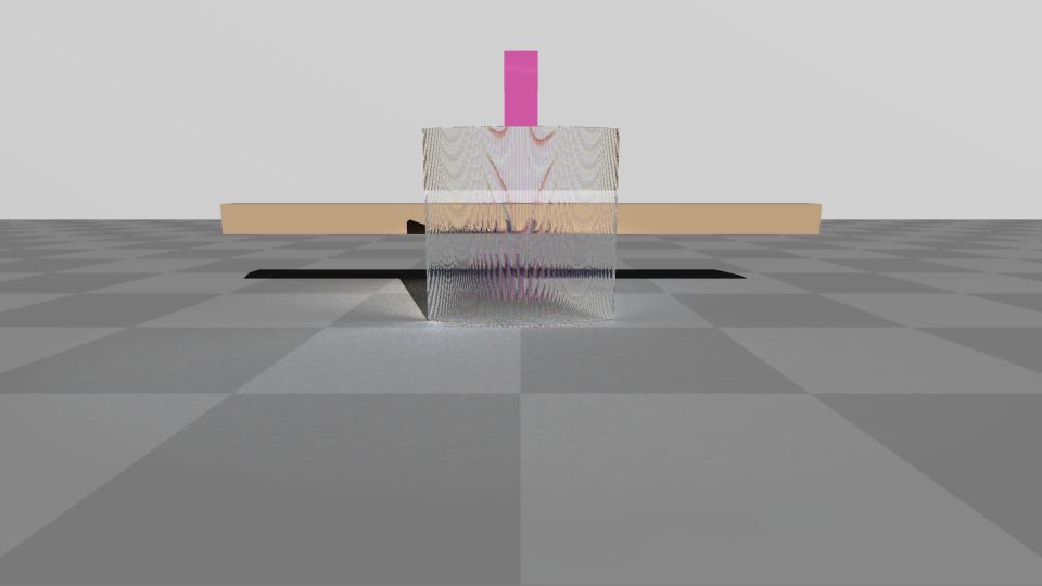

Hi Folks,
After watching this video https://www.youtube.com/watch?v=G93bju1qCSI I
endeavored to make a POV version and it worked fairly well.
Here's a front view:
Download 'invisibilityshield_front.jpg' (22 KB)
Preview of image 'invisibilityshield_front.jpg'

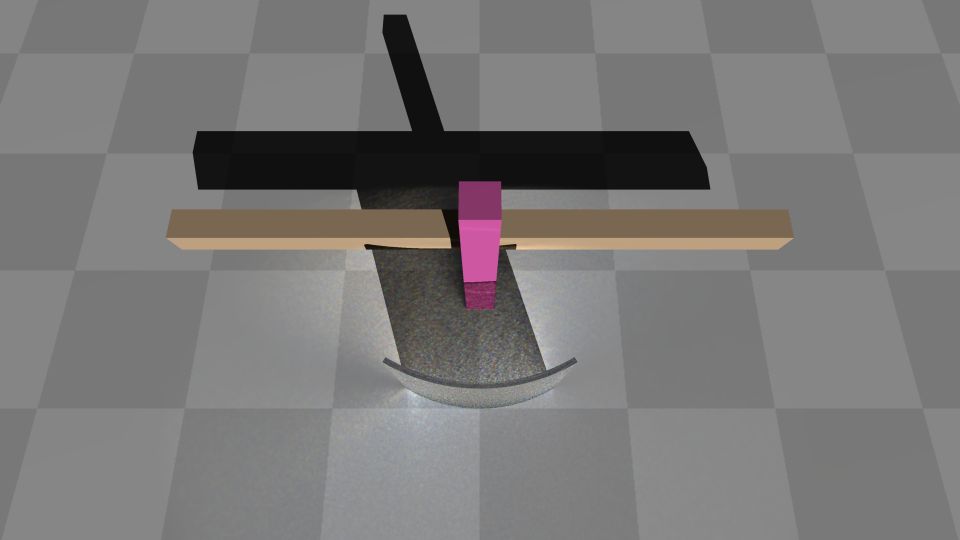

And a top view:
Download 'invisibilityshield_top.jpg' (23 KB)
Preview of image 'invisibilityshield_top.jpg'

So the effect even works in POV-ray; fascinating.
For your shield, are the 'lenticular lens' shapes made with real geometry, or by
using normals on a smooth curved surface?

I used a CSG difference so there wouldn't be any internal or coincident
surfaces. I don't know if that would have made a difference or not.
#local ShieldRadius = 1;
#local Thickness = .03;
#local Angle = 60;
#local LensRadius = .002;
#local ShieldCutout = object {
   #local R0 = ShieldRadius - LensRadius;
   #local DeltaTheta = degrees (asin ((LensRadius / 2) / R0)) * 4;
   difference {
      cylinder {<0, -.1, 0>, <0, 1.1, 0>, ShieldRadius + .2}
      cylinder {<0, -.2, 0>, <0, 1.2, 0>, R0}
      #for (Theta, 180 + Angle, 360 - Angle, DeltaTheta)
         cylinder {<R0, -.2, 0>, <R0, 1.2, 0>, LensRadius rotate -Theta * y}
      #end //#for
   } //difference
} //object
#local Shield = object {
   intersection {
      difference {
         cylinder {<0, 0, 0>, <0, 1, 0>, ShieldRadius + .1}
         cylinder {<0, -.1, 0>, <0, 1.1, 0>, ShieldRadius - Thickness}
         object {ShieldCutout}
      } //difference
      plane {z, 0 rotate Angle * y}
      plane {z, 0 rotate -Angle * y}
   } //intersection
   material {Glass}
   photons {target reflection on refraction on collect off}
} //object

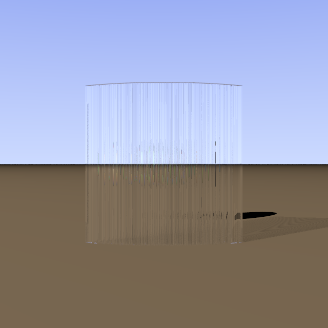

Perfect!
[Whaaaaa....! Who stole my ball....??!?]
Download 'db_invisibility_shield.png' (87 KB)
Preview of image 'db_invisibility_shield.png'

Fantastic - did you use normals to simulate the lenses? Using geometry might be
a limitation because of the huge number of required lenses. Also, did you change
the shape of the shield from circular to oval or parabolic? I'm wondering if
that would make a difference.

I just used your code 'as is'. :-)
