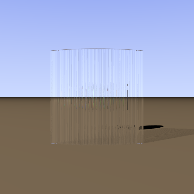

Hi Folks,
After watching this video https://www.youtube.com/watch?v=G93bju1qCSI I
endeavored to make a POV version and it worked fairly well.
Here's a front view:
Download 'invisibilityshield_front.jpg' (22 KB)
Preview of image 'invisibilityshield_front.jpg'

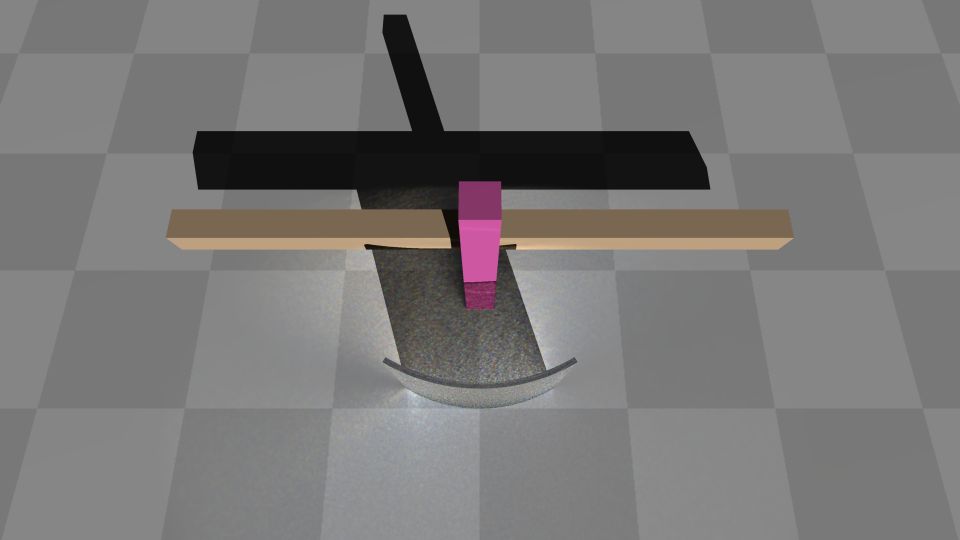

From: Dave Blandston
Subject: Re: Invisibility Shield
Date: 25 Nov 2020 04:30:01
Message: <web.5fbe23283ff595d979416a1f0@news.povray.org>
And a top view:
Download 'invisibilityshield_top.jpg' (23 KB)
Preview of image 'invisibilityshield_top.jpg'
From: Kenneth
Date: 25 Nov 2020 14:55:06
Message: <web.5fbeb5bd3ff595d9d98418910@news.povray.org>
So the effect even works in POV-ray; fascinating.
For your shield, are the 'lenticular lens' shapes made with real geometry, or by
using normals on a smooth curved surface?
Date: 25 Nov 2020 15:30:07
Message: <web.5fbebe9b3ff595d979416a1f0@news.povray.org>
I used a CSG difference so there wouldn't be any internal or coincident
surfaces. I don't know if that would have made a difference or not.
#local ShieldRadius = 1;
#local Thickness = .03;
#local Angle = 60;
#local LensRadius = .002;
#local ShieldCutout = object {
   #local R0 = ShieldRadius - LensRadius;
   #local DeltaTheta = degrees (asin ((LensRadius / 2) / R0)) * 4;
   difference {
      cylinder {<0, -.1, 0>, <0, 1.1, 0>, ShieldRadius + .2}
      cylinder {<0, -.2, 0>, <0, 1.2, 0>, R0}
      #for (Theta, 180 + Angle, 360 - Angle, DeltaTheta)
         cylinder {<R0, -.2, 0>, <R0, 1.2, 0>, LensRadius rotate -Theta * y}
      #end //#for
   } //difference
} //object
#local Shield = object {
   intersection {
      difference {
         cylinder {<0, 0, 0>, <0, 1, 0>, ShieldRadius + .1}
         cylinder {<0, -.1, 0>, <0, 1.1, 0>, ShieldRadius - Thickness}
         object {ShieldCutout}
      } //difference
      plane {z, 0 rotate Angle * y}
      plane {z, 0 rotate -Angle * y}
   } //intersection
   material {Glass}
   photons {target reflection on refraction on collect off}
} //object

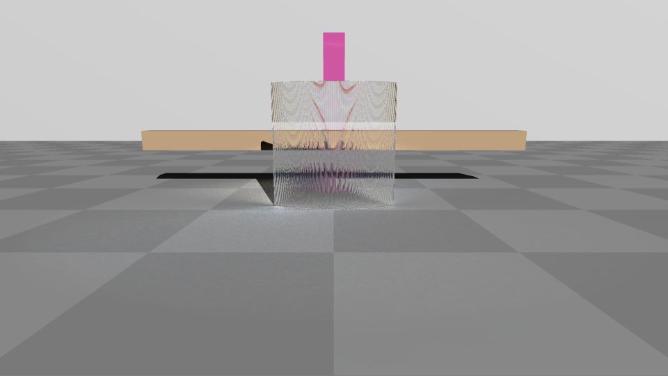

Date: 26 Nov 2020 03:19:06
Message: <5fbf64fa$1@news.povray.org>
Perfect!
[Whaaaaa....! Who stole my ball....??!?]
Download 'db_invisibility_shield.png' (87 KB)
Date: 26 Nov 2020 04:40:01
Message: <web.5fbf76ef3ff595d979416a1f0@news.povray.org>
> Perfect!
> Thomas
Fantastic - did you use normals to simulate the lenses? Using geometry might be
a limitation because of the huge number of required lenses. Also, did you change
the shape of the shield from circular to oval or parabolic? I'm wondering if
that would make a difference.
Have a great day!
Kind regards,
Dave Blandston
Date: 27 Nov 2020 02:31:03
Message: <5fc0ab37@news.povray.org>
Op 26/11/2020 om 10:35 schreef Dave Blandston:
I just used your code 'as is'. :-)
