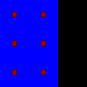

Result of rendering in attachment. First line, two rendering in one pass and
their difference. Second line, rendering in one pass, rendering by chunks, their
difference (no antialising). Third line, rendering in one pass, rendering by
chunks, their difference (with antialising, check the value of the pixels at the
limit of the sphere and the background, they are not [0,0,0]). Both Gimp and my
code give me the same differences so I'm confident the culprit is POV-Ray.
Pascal
Download 'partialrenderingdifference.png' (4 KB)
Preview of image 'partialrenderingdifference.png'

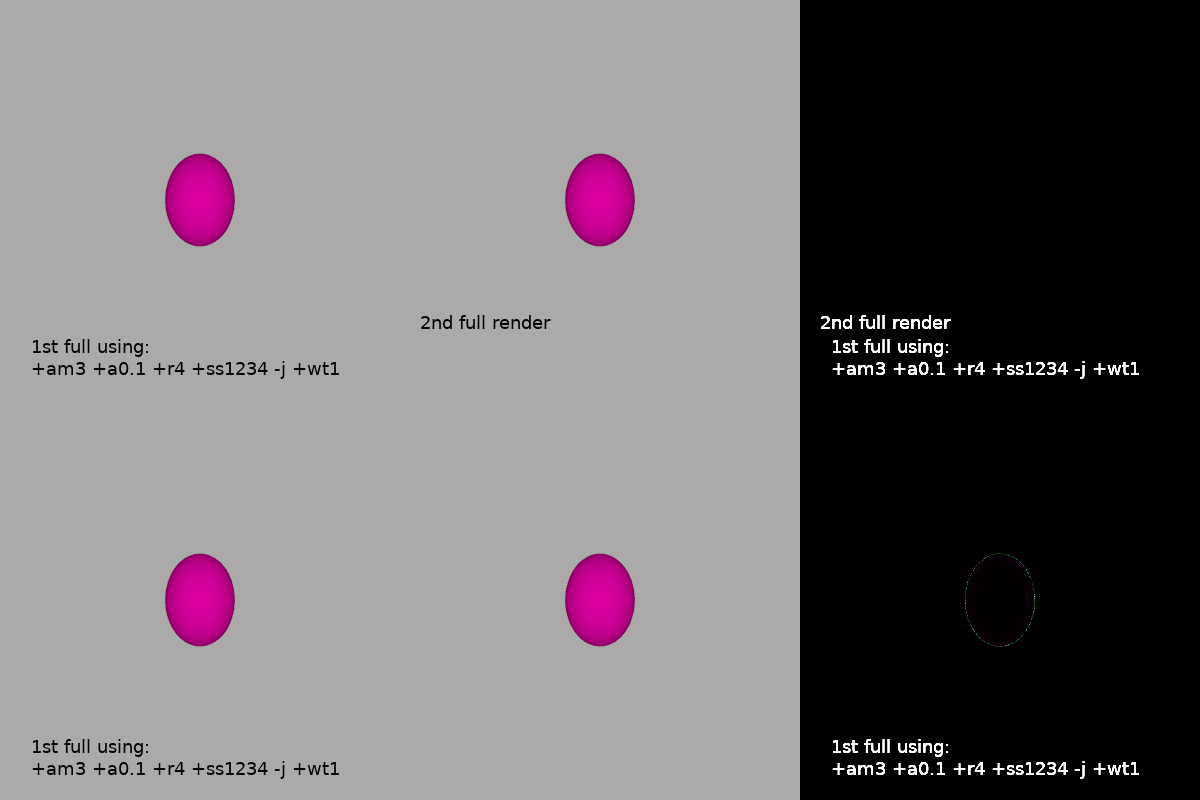

From: William F Pokorny
Subject: Re: Different result between partial rendering and normal rendering ?
Date: 18 Jun 2019 09:44:29
Message: <5d08eabd$1@news.povray.org>
On 6/17/19 11:08 AM, BayashiPascal wrote:
> Hi there,
> I've realized something I wasn't aware until now and wanted to ask for your
> opinion.
Hi Pascal,
I had a little time this morning before being busy with real life. So,
thought I'd play with what you posted but in the current v3.8 master
branch as it's the only place anything might be updated.
I rendered your scene at 400x400 instead of 100x100. To my surprise
using only the default +a type anti-aliasing I see a pixel or sometimes
a few which are 1/255 by channel in magnitude different(1). In the
400x400 render, and just +a, this happens with a single pixel at 231,218
which isn't even on sub-render boundary. Using still method one but
with: +am1 +a0.1 +r3 I see again that pixel and an additional 2 in the
same column above it. All near the edge of the sphere so AA is in play.
Weird. Guessing maybe some sub pixel offset when rendering sub blocks.
The image attached used the new to v3.8 +am3 mode. In the top row two
different full renders are compared and they match exactly. In the
bottom we compare the top left full to an image assembled by chunks. The
multiplier on the differences is 4x. Looks like +am3 better brings out
whatever the issue is.
Still, not sure I'll open up an issue. Something like this is going to
be way down on anyone's to-do list. Opinions?
You could try +am2 in 3.6 as I've not see issues with it in 3.8.
Probably also faster. The jitter off comments others made stands. I also
tested with one thread to be sure threads>1 not a problem in v3.8.
Bill P.
(1) - Not thinking about it very much - in 3.6, if not using
assumed_gamma 1.0, the differences might be a little more dramatic in
the resultant image though probably still hard to see.
Download 'chunksstory.png' (46 KB)
Preview of image 'chunksstory.png'

> Hi Pascal,
> Bill P.

I think I'll open up a github issue. I was seeing differences with
jitter off and the +am3 differences peaked at 80/255 per color channel
though usually smaller. Further, I remembered we already have bugs and
feature issues open related to +sc, +ec, +sr +er control in:
https://github.com/POV-Ray/povray/issues/312
and
https://github.com/POV-Ray/povray/issues/279
This issue should be at least considered when someone gets to looking at
either of those.
Bill P.
