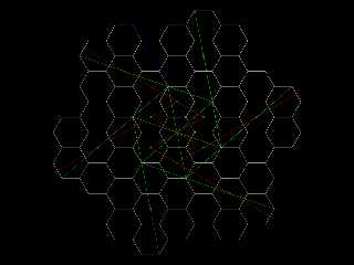

It seems to me that the engine used to throw an error when this happened...
Render attached. The last orange point is out of position. Why this happens at
-60 or 300 degrees and not on the other side, I don't know.
I found a possible workaround, but it's not pretty.
Watch the value of m1:
m1 = 0.500000 / -0.866025 = -0.577350
m2 = 0.327327 / -0.944911 = -0.346410
PC: <1.500000,0.866025,0.000000>
PD: <0.000000,1.732051,0.000000>
PE: <2.000000,1.732051,0.000000>
PF: <-0.500000,2.598076,0.000000>
m1 = -0.500000 / -0.866025 = 0.577350
m2 = -0.654654 / -0.755929 = 0.866025
PC: <0.000000,1.732051,0.000000>
PD: <-1.500000,0.866025,0.000000>
PE: <-0.500000,2.598076,0.000000>
PF: <-2.500000,0.866025,0.000000>
m1 = -1.000000 / -0.000000 = 3900231685776980.500000
m2 = -0.981981 / 0.188982 = -5.196152
PC: <-1.500000,0.866025,0.000000>
PD: <-1.500000,-0.866025,0.000000>
PE: <-2.500000,0.866025,0.000000>
PF: <-2.000000,-1.732051,0.000000>
m1 = -0.500000 / 0.866025 = -0.577350
m2 = -0.327327 / 0.944911 = -0.346410
PC: <-1.500000,-0.866025,0.000000>
PD: <-0.000000,-1.732051,0.000000>
PE: <-2.000000,-1.732051,0.000000>
PF: <0.500000,-2.598076,0.000000>
m1 = 0.500000 / 0.866025 = 0.577350
m2 = 0.654654 / 0.755929 = 0.866025
PC: <-0.000000,-1.732051,0.000000>
PD: <1.500000,-0.866025,0.000000>
PE: <0.500000,-2.598076,0.000000>
PF: <2.500000,-0.866025,0.000000>
m1 = 1.000000 / -0.000000 = -7800463371553961.000000
m2 = 0.981981 / -0.188982 = -5.196152
PC: <1.500000,-0.866025,0.000000>
PD: <1.500000,0.866025,0.000000>
PE: <2.500000,-0.866025,0.000000>
PF: <2.000000,1.732051,0.000000>
A.D.B.

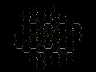

From: Anthony D  Baye
Subject: Re: Divide by negative zero
Date: 26 Oct 2018 00:25:01
Message: <web.5bd296ffa617eb51fd6b6fe10@news.povray.org>
What it should look like.
A.D.B.

From: clipka
Date: 26 Oct 2018 02:02:46
Message: <5bd2ae06$1@news.povray.org>
Am 26.10.2018 um 05:41 schrieb Anthony D. Baye:
> Version 3.8.0-alpha.9606898.unofficial
That's on Linux, I presume?
POV-Ray does produce a warning if the second operand compares /equal to
zero/.
Now as you've already noticed, there are two different zero values: A
positive and a negative.
According to the C++ standard, /both/ values should compare equal to
zero, so you /should/ get a warning when dividing by negative zero.
- BUT -
POV-Ray for Linux is usually compiled with `-ffast-math`. In this mode,
the compiler does some smart floating-point optimizations - by cutting
corners and /violating the standard/ for various special cases.
I don't know the details, but this sounds just like the kind of
optimizations `-ffast-math` would do: Refuse to consider negative zero
equal to (positive) zero just because hey, how can two values be equal
if they have different binary representation.
There is no reliable way to work around this: Since this is all about
the compiler violating the standard for the sake of optimization, there
is no guarantee that a workaround would actually kick in, as it might
also be subject to non-standard-compliant optimizations - or
optimizations /based/ on the standard.
For example, if we chose to work around this by comparing the divisor
with positive zero /and/ with negative zero, the compiler might decide
that since positive and negative zeros are equivalent according to the
standard, it can just as well drop one of the comparisons. Theoretically
we might even end up making things worse, because the compiler might
choose to keep the comparison with negative zero rather than the one
with positive zero.
A compiler violating the C++ standard is free to contradict itself in
the presumptions it uses for optimizations.
So if you want to be sure that you're not dividing by negative zero,
either (a) explicitly test if the divisor is equal to zero in your scene
code (this is reliable because POV-Ray's equality operator is
implemented to use an error margin), or (b) re-compile POV-Ray without
`-ffast-math`.

"Kenneth" <kdw### [at] gmailcom> wrote:
> > zero/.
> > [etc]
> For what it's worth, in POV-Ray for Windows v3.7.1 beta 9, I see the same
> results as Anthony's original image-- the misplaced orange dot and the missing
> hexagons at the top.
> The only error messages I get are the expected ones: A missing assumed_gamma,
> and the #version directive not being the first statement in the scene.
> (By adding #version 3.71 , I get the same results, except for a quality
> difference in the renders. But no *new* warning message.)
I've got it working.  There are a couple lines in the IPoint macro that "Fix"
the problem (at least until offsets get really big) by ensuring that the slope
is never undefined.
I'm sure there's a method for finding intersections of two lines that isn't
vulnerable to this problem, but I haven't figured it out yet.
A.D.B.

From: JimT
Date: 30 Oct 2018 05:55:01
Message: <web.5bd82976a617eb51be7517870@news.povray.org>
> Regards,
> A.D.B.
Anthony,
If you use the x(tVal1) = UI1 + Ud*tVal1 , y(tVal2) = VI1 + Vd*tVal2 formulation
for the lines then (x(tVal1)-y(tVal2)).Ud = 0 and
(x(tVal1)-y(tVal2)).Vd = 0 give 2 equations for tVal1 and tVal2. These would
give the nearest points of the pair of lines in 3D or the intersection point of
lines in 2D.
In the following, the only division is by detM, which will only be zero if the
lines are parallel. This will therefore not tread on the +-0 problem POV Ray
seems to have.
Thanks,
JimT
#macro IPoint(UI1, UI2, VI1, VI2)
  #local Ud      = vnormalize(UI2 - UI1);
  #local Vd      = vnormalize(VI2 - VI1);
  #local UddotVd = vdot(Ud,Vd);
  #if(UddotVd    = 1)
    #local rX    = 0;  // Parallel lines so no soln or infinite solns
    #local rY    = 0;
  #else
    #local UV1   = UI1 - VI1;
    #local b1    = vdot(-UV1,Ud);
    #local b2    = vdot( UV1,Vd);
    #local detM  = 1 - UddotVd*UddotVd;
    #local tVal  = (b1 + UddotVd*b2)/detM;
    #local Upt   = UI1 + Ud*tVal;
    #local rX    = Upt.x;
    #local rY    = Upt.y;
  #end
  #local retval  = <rX,rY, 0.0>;
  retval
#end
