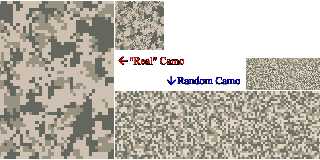

I would like to use some digital camouflage in a scene. As it turns out, the
design philosophy behind digital camouflage is very interesting and
sophisticated. According to the Wikipedia entry, "Digital camouflage is a type
of camouflage pattern combining micro- and macro patterns, often with a
pixellated look created with computer assistance. The function is to provide
military camouflage over a range of distances, or equivalently over a range of
scales, in the manner of fractals."
So far I have set up the scene but used a simple random selection of three
colors to create the digital camo grid (which is represented by a 2-dimensional
array where each entry indicates one of the three possible colors). Now it is
time to fine-tune the camo. I don't have any idea how to approach this task!
I have attached a demonstration picture showing what appears to be
professionally produced digital camouflage that I would like to try to emulate
and also my simple version which I generated with POV-Ray. It's very obvious
that the algorithm used to create the "real" camo is far superior to simple
random selection. The difference becomes even more obvious in the
thumbnail-sized images.
So I'm curious if this happens to be of interest to anyone who may want to make
a suggestion, or who may have accomplished something similar to this in the
past. This may be beyond my ability due to my limited math skills but I will
give it a try...
PS - The .jpg version of the sample picture produced a larger file size than the
..png version so I posted the .png.
Download 'camodemo.png' (102 KB)
Preview of image 'camodemo.png'

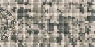

Thanks for the suggestion! If I used your code correctly (had to make a couple
adjustments) then the results are a very nice traditional-looking camo pattern
(render attached). What I'm attempting is the trendy pixelated "digital" style
camo pattern similar to Marine Pattern (MARPAT) or Universal Camouflage Pattern
(UCP). These patterns are generated using fractal functions in order to maintain
the similar pattern appearance at short and far distances. I find that this is
well beyond my ability! I have been reading about camouflage design and it's
very interesting and scientific, but requires more math skill than I possess.
Dave Blandston
Download 'cellcamo.jpg' (123 KB)
Preview of image 'cellcamo.jpg'

I did in fact decide to cheat and use a sample picture. I used the eval_pigment
() function to obtain and reproduce the pattern for my use. I have attached an
image of the final result, which will be a background for a bumper sticker.
Dave Blandston
