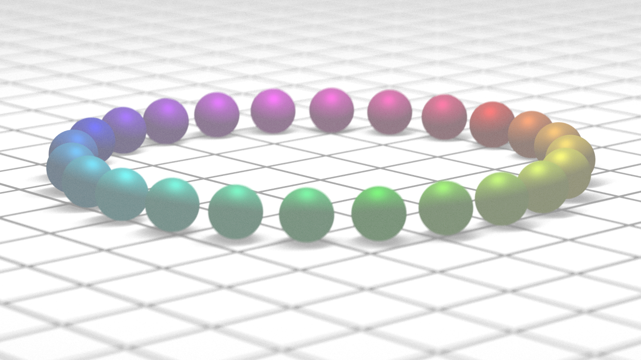

Hi,
After many years of coding, the realistic finish has never been my best point.
Wow could I fix the unrealistic finish of these spheres?
The more I look at them, the more "fake" they look on the image.
I can't find the right combination of ambient, radiance and brilliance.
Regards
B. Gimeno
pd, the source for the Red Sphere
            texture {
              pigment { Red
              finish { specular .5
                       metallic
                       ambient .2
                       diffuse .5
Download 'btfh2.png' (703 KB)
Preview of image 'btfh2.png'

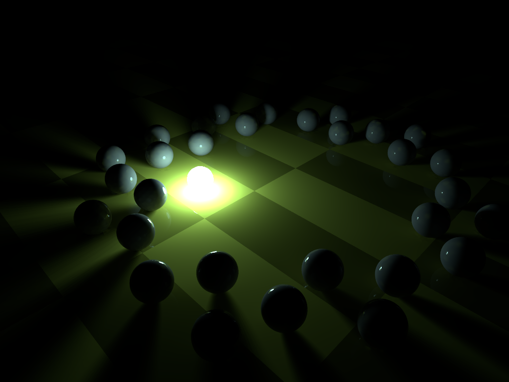

I post an image for your reference,
sphere{
<0,0.14,0.3>, 0.14
    texture{
        pigment{rgb<0.19,0.18,0.19>}
        finish{ambient 0 diffuse 1 brilliance 1.5 reflection {0.01,0.2 falloff
3}}
Download 'finish test2 6.png' (236 KB)
Preview of image 'finish test2 6.png'

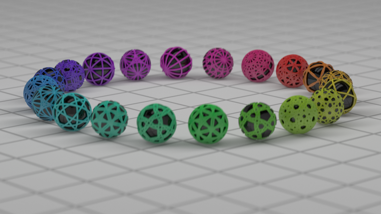

Download 'finalrender.png' (869 KB)
Preview of image 'finalrender.png'

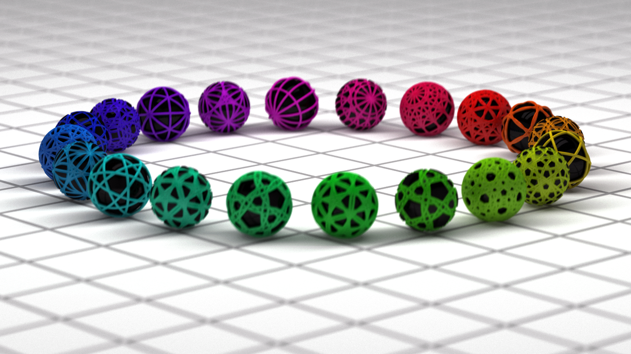

and the photoshopped one
Download 'editedrender.png' (1026 KB)
Preview of image 'editedrender.png'

beautiful spheres.

I have just noticed that the edited version almost completely eliminates the
reflection of the spheres. And this makes me think that when you want a
realistic version of a scene you're actually asking for a retouched version of
reality, just as advertising photography has taught us.

Not me. I'm going for the unedited version.
Maybe it's a matter of having a calibrated display. Maybe it's personal
taste.
