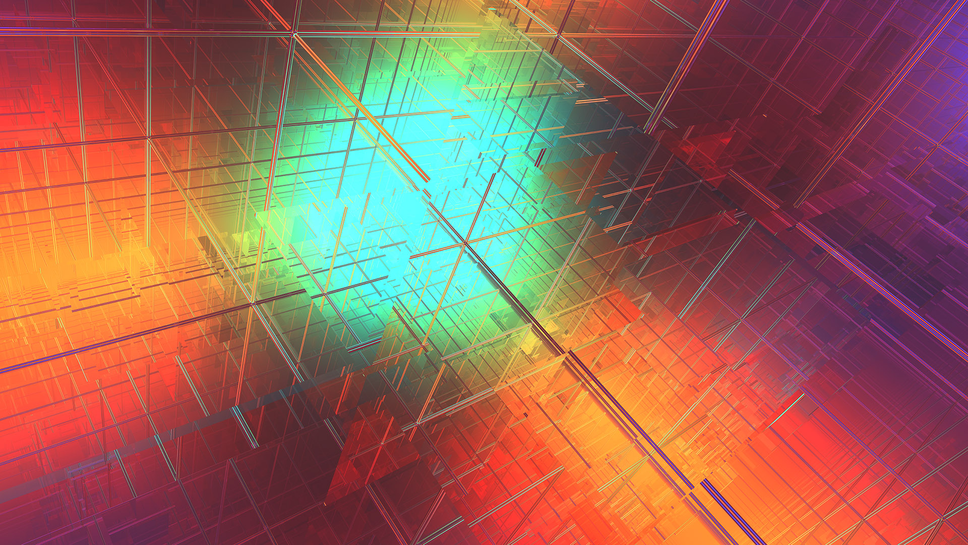

Abstracts are nice, especially those true to the motto "reduction to the
essentials".
Here I variated a nice scene of Christian Perle (
http://chris.silmor.de/ray/POVImgs2.html ).
Essential here is a max_trace_level higher than 5.
Code is short enough to show it here -
// A variation of:
// Inside the box
// 9/2016 Christian Perle
// http://chris.silmor.de/ray/pov2/inner_box.html
// http://chris.silmor.de/ray/POVImgs2.html // for further images and sources
#version 3.7;
global_settings {
        assumed_gamma 1
        max_trace_level 28
camera {
        perspective
 location <-0.24,0.2,-1.3>
 direction 1.2*z
 look_at <0,-0.05,1>
 rotate <0,0,-11>
        right x*image_width/image_height
#macro RoundBox ()
#local A = <-0.5,-0.5,-0.5>;
#local B = <0.5,0.5,0.5>;
#local Edge = 0.01;
#local AA = <min (A.x,B.x),min (A.y,B.y),min (A.z,B.z)>;
#local BB = <max (A.x,B.x),max (A.y,B.y),max (A.z,B.z)>;
#local LBF = AA;
#local RBF = <BB.x,AA.y,AA.z>;
#local RBB = <BB.x,AA.y,BB.z>;
#local LBB = <AA.x,AA.y,BB.z>;
#local LTF = <AA.x,BB.y,AA.z>;
#local RTF = <BB.x,BB.y,AA.z>;
#local RTB = BB;
#local LTB = <AA.x,BB.y,BB.z>;
merge {
        sphere {LBF, Edge}
        sphere {RBF, Edge}
        sphere {RBB, Edge}
        sphere {LBB, Edge}
        sphere {LTF, Edge}
        sphere {RTF, Edge}
        sphere {RTB, Edge}
        sphere {LTB, Edge}
        cylinder {LBF, RBF, Edge}
        cylinder {LBB, RBB, Edge}
        cylinder {LTB, RTB, Edge}
        cylinder {LTF, RTF, Edge}
        cylinder {LBF, LTF, Edge}
        cylinder {RBF, RTF, Edge}
        cylinder {RBB, RTB, Edge}
        cylinder {LBB, LTB, Edge}
        cylinder {LTB, LTF, Edge}
        cylinder {LBB, LBF, Edge}
        cylinder {RTB, RTF, Edge}
        cylinder {RBB, RBF, Edge}
        box {AA-Edge*x, BB+Edge*x}
        box {AA-Edge*y, BB+Edge*y}
        box {AA-Edge*z, BB+Edge*z}
#end
#declare RotBox =
object {
 RoundBox ()
 rotate 45*x
 rotate 35.26438968*z
merge {
 object {RotBox scale 0.9 interior {ior 1}}
 object {RotBox translate <1,0,0> interior {ior 1.5}}
 object {RotBox translate <-1,0,0> interior {ior 2}}
 object {RotBox translate <0,1,0> interior {ior 2.5}}
 object {RotBox translate <0,-1,0> interior {ior 3}}
 object {RotBox translate <0,0,2.5> interior {ior 3.5}}
 object {RotBox translate <0,0,-2.5> interior {ior 4}}
 hollow
 pigment {color rgb 0.05}
 finish {
  reflection 1
  phong 1
  phong_size 20
  irid {0.3 thickness 0.45}
 rotate 90*x
Norbert
Download 'inside the box_nk.jpg' (875 KB)
Preview of image 'inside the box_nk.jpg'

That is beautiful! And thank you for the introduction to Christian Perle. I
haven't come across his stuff before.
Cheers,
Simon.

Very nice.
I have a question : Why set those IORs? There is no transparency and no
fresnel reflection, so, nothing were the ior can have any effect.
Now, let render this with fresnel turned ON or with some transparency.

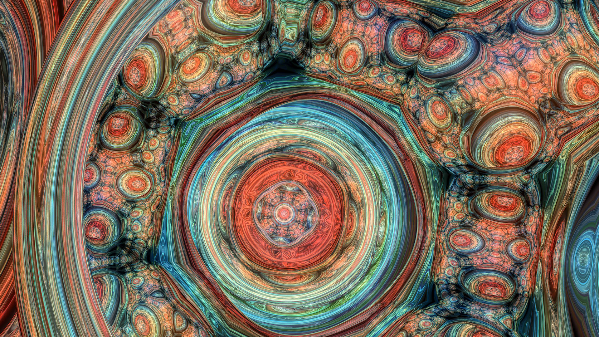

From: Norbert Kern
Subject: Re: reduction to the essentials
Date: 9 Jul 2017 12:30:01
Message: <web.5962580468cc8a4f2926c5a90@news.povray.org>
> Very nice.
> Alain
Ha - very smart Alain,
you caught me...
Fresnel lets the iridescence disappear - and iridescence is the second
essential.
Here's another image of Christian Perle (with revised code, I hope).
// A variation of:
// Inside the blob
// 10/2005 Christian Perle
// http://chris.silmor.de/ray/pov2/inner_blob.html
#version 3.7;
global_settings {
        assumed_gamma 2.2
        max_trace_level 7
camera {
        location <-0.24,0.2,-1>
        direction 1.6*z
        look_at <0,0,1>
        rotate <0,0,11>
light_source {<0,0,0> color rgb <0,0.25,0>}
light_source {<0.1,-0.1,0> color rgb <0.25,0,0>}
light_source {<-0.1,0.1,0> color rgb <0,0,0.25>}
blob {
        threshold 0.6
        component 1, 0.8, <0,0,0>
        component 1, 1, <1,0,0>
        component 1, 1, <-1,0,0>
        component 1, 1, <0,1,0>
        component 1, 1, <0,-1,0>
        component 1, 1, <0,0,1>
        component 1, 1, <0,0,-1>
        finish {
                reflection 1
                phong 1
                phong_size 6
                irid {0.15 thickness 0.38}
        rotate 100*x
Norbert
Download 'inside the blob_nk.jpg' (775 KB)
Preview of image 'inside the blob_nk.jpg'

From: clipka
Date: 9 Jul 2017 15:07:30
Message: <59627ef2$1@news.povray.org>
Am 09.07.2017 um 18:24 schrieb Norbert Kern:
What?
It shouldn't do that.
From: Norbert Kern
Date: 9 Jul 2017 17:35:01
Message: <web.5962a10d68cc8a4f2926c5a90@news.povray.org>
> What?
Then - try this replacement of the terminal part of code in message 1.
You will recieve pure dark grey (rgb 0.05).
Norbert
#declare RotBox =
object {
 RoundBox () scale 1.2
 rotate <45,0,35>
merge {
 object {RotBox scale 0.9}
 object {RotBox translate <1,0,0>}
 object {RotBox translate <-1,0,0>}
 object {RotBox translate <0,1,0>}
 object {RotBox translate <0,-1,0>}
 object {RotBox translate <0,0,2.5>}
 object {RotBox translate <0,0,-2.5>}
 hollow
 pigment {color rgb 0.001}
 finish {
  reflection {1 fresnel on}
  irid {0.05 thickness 0.315}
 rotate 90*x
