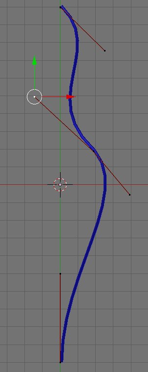

lathe { bezier_spline 8,
    <0,1><0.25,0.75><-0.07594,0.5><0.1875,0.1875>
    <0.1875,0.1875><0.3929,-0.05616><0,-0.5><0,-1>
File '/tmp/Empty.pov' line 17: Parse Error: Incorrect point in lathe.
Fatal error in parser: Cannot parse input.
Render failed
I can't appropriate to control point the negative value...
Why?????
To set the necessary form, I need a negative value!
At the same time the curve doesn't cross null value...
Look attachment:
Download 'lathe.jpg' (27 KB)
Preview of image 'lathe.jpg'

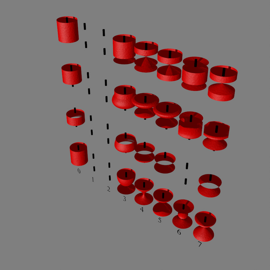

The issue looks to be this code in the parser for the lathe object :
         for (i = 0; i < Object->Number; i++)
                 Parse_Comma();
                 Parse_UV_Vect(Points[i]);
                 if ((i > 0) && (i < Object->Number - 1) &&
(Points[i][X] < 0.0))
                         Error("Incorrect point in lathe.");
which is written in a way which does not allow the bezier control points
to swing to minus x while making some allowance for other curve's
control points.
In other words I think it is testing the control points and not the
fixed end points in each of the bezier curve segments.
Probably simple enough I could attempt a fix... Needs a conditional
based on whether we have bezier curve I think. If someone else is going
after a fix please speak up, otherwise I'll step up and try for one.
Bill P.

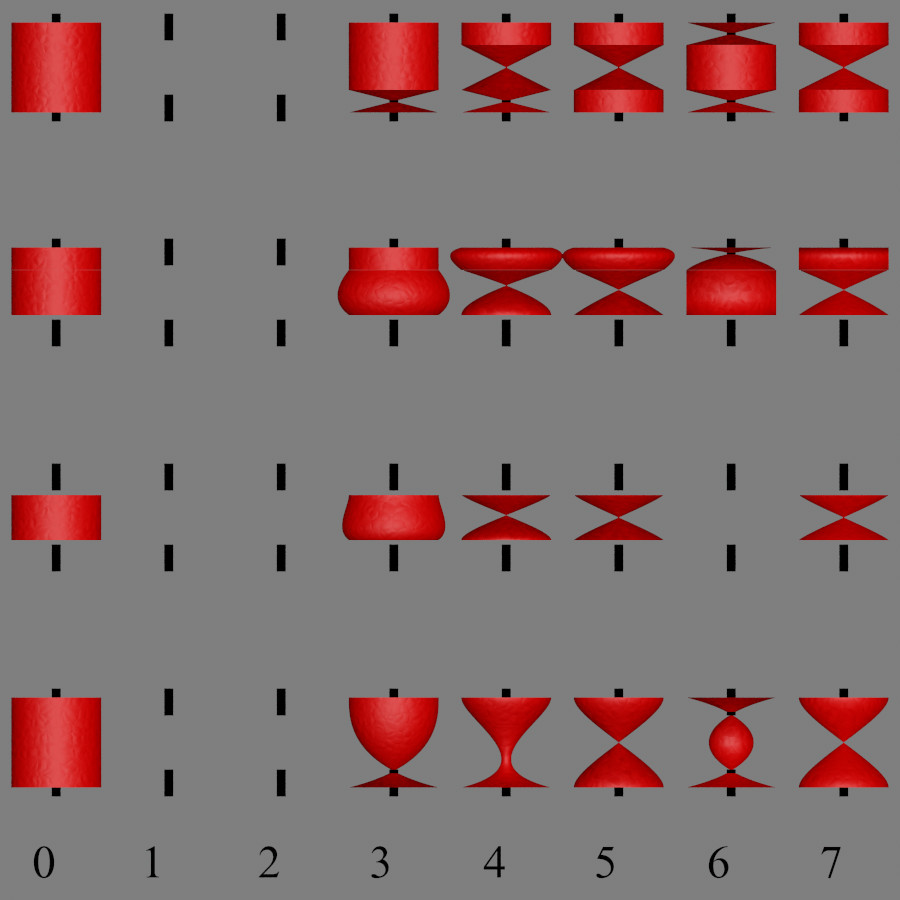

From: William F Pokorny
Subject: Re: Lathe. Bezier_spline. Problem
Date: 2 May 2016 10:37:17
Message: <5727661d$1@news.povray.org>
On 05/02/2016 09:58 AM, clipka wrote:
> Am 02.05.2016 um 14:57 schrieb William F Pokorny:
> That is indeed the location in the code that rejects the negative value.
> I would want more to be done than just address the symptoms
Understand. I too recognize more that just the testing of on curve
points for the bezier curve was wrong in what we have today.
Namely it is wrong/incomplete for other curve types too. My initial code
update is this for on curve point test :
                 switch (Object->Spline_Type)
                         case LINEAR_SPLINE :
                                 if (Points[i][X] < 0.0)
                                         Error("Lathe with linear spline
has a point with an x value < 0.0.");
                                 break;
                         case QUADRATIC_SPLINE :
                                 if ((i > 0) && (Points[i][X] < 0.0))
                                         Error("Lathe with quadratic
spline has a point with an x value < 0.0.");
                                 break;
                         case CUBIC_SPLINE :
                                         Error("Lathe with cubic spline
                                 break;
                         case BEZIER_SPLINE :
                                 if (((i%4 == 0) || (i%4 == 3)) &&
                                         Error("Lathe with Bezier spline
                                 break;
Which seems to be doing the right sort of testing depending on curve
type in forcing on curve points to be >=0 in x.
Thanks for the testing ideas below. Some I'd thought of or believe I've
done in the past, some not.
Rambling I suspect too, both negative control and on curve points will
run - though us users might well be confused by any result if really true.
If the developers want to allow this, I suppose deleting the current
check is the way to go instead.
In any case for the moment, let me test the cases below with all parser
checking off for the different curve types & I will report the results
here.

From: Bald Eagle
Date: 2 May 2016 12:40:00
Message: <web.572782509e3d3d24b488d9aa0@news.povray.org>
I have always wondered what the big deal about negative values was, since once
it gets revolved 180 degrees, it's the positive value.
Can the on-curve points simply be redefined to be positive?
on_curve[n] = abs(original_curve[n]) ?
I could of course, be way off base with this.
The pre-evaluation of the on-curve points for things like Bezier curves would be
an extra subroutine and parser hog, but probably shouldn't be too bad unless
there were a lot of such objects to evaluate.
From: LanuHum
Date: 2 May 2016 13:30:01
Message: <web.57278e889e3d3d247a3e03fe0@news.povray.org>
No,no.
In bezier only 4 control points (P0,P1,P2,P3)
P0,P3 belong a curve, P1 of P2 don't belong a curve.
If P1 = (-2,2), they won't be replaced by a point (2,2).
Other curve will turn out absolutely.
In order that all points of a curve were in positive coordinates, not
necessarily that P1 and P2 also were in positive coordinates.
In the case provided by me the ideal surface of revolution shall turn out.
Restriction from povray is unjustified.

OK some test results from negative lathe spline values with the current
parse checking off. All splines used have 4 points.
The four rows, top to bottom, are linear, quadratic, cubic and bezier
splines respectively.
The columns 1-7 are:
0 - All X coordinates are positive.
1 - All X coordinates are negative.
2 - All X coordinates are 0.
3 - First point's X coordinate is negative.
4 - Second point's X coordinate is negative.
5 - First and second point's X coordinates negative.
6 - Second and third point's X coordinates negative.
7 - Third and fourth point's X coordinates negative.
I think I covered all the cases somewhat, but if not let me know.
To my eyes we get what one might expect(1) with negative coordinates, so
running with better warnings or no checking at all of the points in the
spline is probably OK.
Bill P.
(1)- except perhaps that quadratic is a bit noisy, but probably it is
not much used.
Download 'orthographic.jpg' (85 KB) Download 'perspective.jpg' (80 KB)
Preview of image 'orthographic.jpg'
Preview of image 'perspective.jpg'
